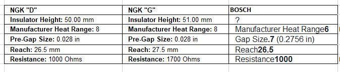

The original part number are plugs by NGK , the newer is a Bosch plug and was updated around 2018. Fyi the Bosch plugs are hotter than the NGK , I bought the original NGK plugs outside of the dealership (FCP Euro) and stuck with that since I'm tuned.

For sure only one plug per cylinder on our motors, and i believe all of the newer MB motors. The 2 plug per cyl was from an older era of MB motors.
Did you give the dealer your VIN to look up the part # with?
As for the Bosch vs NGK this is the first ive seen this and it has me questioning which is a better choice.
From NGK site they list 2 options - SILZKFR8G7S (96427) and SILZKFR8D7S (95875) (NGK site says "sell out and order G configuration" on the D style description)
Bosch lists EVO 96347.
Both copper core, iridium top with same thread and hex sizes.
As mentioned, the Bosch has a 2 range hotter plug than the NGK. This is not typically what you want for boosted applications and performance.
I would think lower resistance is also preferred as it would mean more power to the electrode and less wear on the boot/coil.
Not sure how an extra mm of reach would effect cooling and flame front.

The original NGK that I pulled from the engine were the SILZKFR8D7S (NGK-95875). The Bosch plug that the dealership sold me almost 2 years ago was BOSCH V6S113328 (BOSCH 7434)
