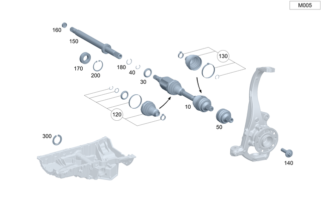

CV Joint Boot Kits
https://mbparts.mbusa.com/search?sea...Kit&ptid=11618

I see that might be what forum member TwoC400s mentioned, good find!
​​​​​​Part labeled #50 in the diagram above:
Left side unit is MB part # 2053309910
https://mbparts.mbusa.com/oem-parts/...int-2053309910
The boot kit is separate, you'll also need a new axle nut since it's TTY.
I don't have the factory manual. You just disassemble the front brakes and suspension enough to remove the axle, put the shaft in a vice, remove the old boot, drive the CV unit off the shaft with a hammer and a brass punch, then do it all in reverse to put it back in.
