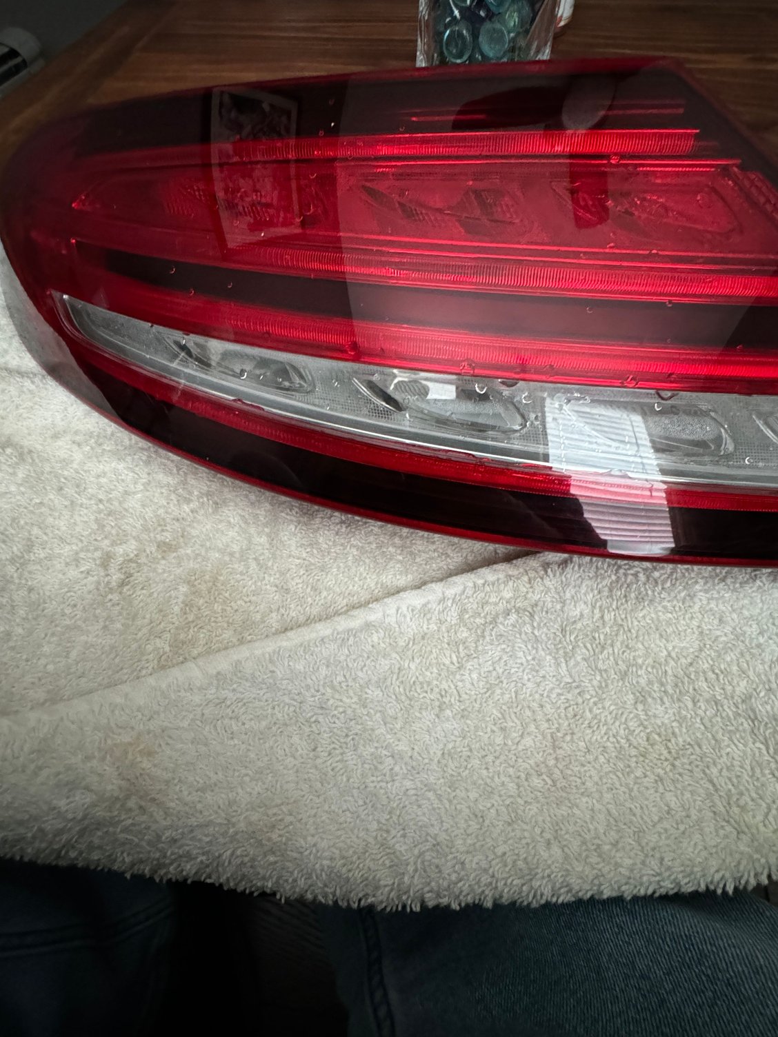

Tail light is leaking through the front lens where the red plastic meets the white ( backup light) of the plastic. It is the driver side left outer light assembly. I confirmed this by gently blowing compressed air on tail light and can see water under the lens in the white plastic area moving with the air current. Is there a way to reseal this area? Does lens actually come apart from the assembly or is it permanently sealed during manufacturing? Just looking to fix without having to spend big $$ on a whole light replacement

so, I went over front of tail light to see if there are any holes anywhere for moisture release but I don’t see anything. I see a vent in the back of light but no moisture is getting in through there. I went through a car wash recently and that’s when I noticed actual water and not just condensation in light. I just took compressed air and lightly blew air through tge vent in tge back of light and it comes out in the area I talked about in original post. It doesn’t seem correct that water should be getting through here as there is the condensation vent in the back of light.

no. I don’t notice anything out of the ordinary. Just that water coming in through the front between the two different colored lenses.

water is definitely getting in between a minute separation between the red and clear lens. Must be a defect in tge manufacturing process. So I ordered a new one as I am not going to chance moisture getting into the wiring to the lights and causing more of an issue.
