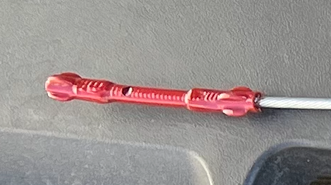

make the cable straight by hands (without cracking the plastic using pliers)
This might help give you a brake with the popping.
I tell you... mine does not pop up and my vac.pp check valve never blown out either.
My dipstick is pretty straight...

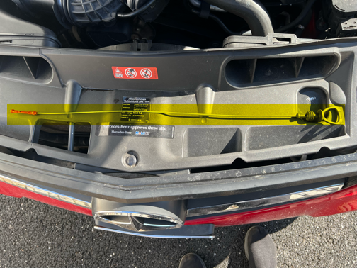

really straight
it looks nearly right... but not straight enough!!
tip is bent more than it should
imagine this was a "push rod"....
roll it to check "out-of-round" bend.
go easy bending seasoned plastics
Make it really-really straight by hand than it should quit getting up.

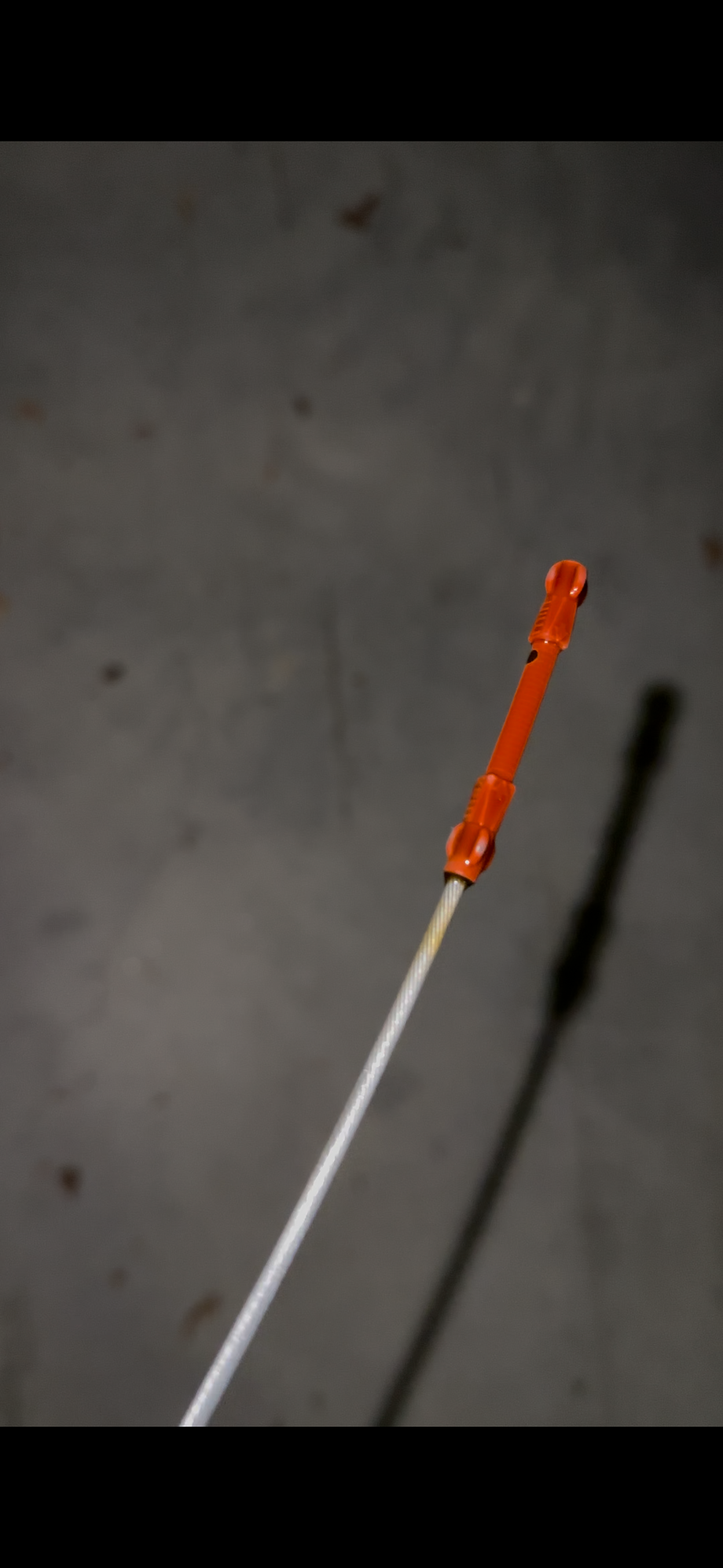

A little clearer.

STRAIGHT AS AN ARROW
A little clearer.
Have you noticed how dipstick twist itself around when you insert it??
​​​​​MB may well have designed a new service item to renew.... we're going to miss not having a dipstick.
