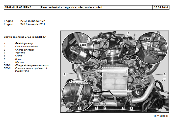

The other MAP sensor is shown in the top left of the picture as B28/6.
Old Feb 12, 2025 | 11:21 AM
JettaRed's Avatar
Veteran: Army
iTrader: (1)
Joined: Nov 2016
Posts: 7,847
Likes: 3,496
From: Maryland
Or #40 in this diagram. (Drives me nuts that the intercooler is listed with the radiator instead of the intake.)
