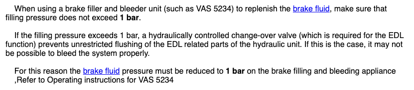

Be sure NOT to over-pressurize the power bleeder when using it. Different manufacturers have different tolerances, but if you set the pressure too high, there may be a valve that limits the bleeding function. Below are instructions for bleeding my 2004 Audi TT quattro. As you can see, the pressure of the bleeder must not exceed 1 bar. I will check WIS to see if there are similar warnings for Mercedes.
Old May 4, 2025 | 03:07 PM
JettaRed's Avatar
Veteran: Army
iTrader: (1)
Joined: Nov 2016
Posts: 7,847
Likes: 3,496
From: Maryland
Here you are boys and girls. It appears Mercedes says to set the pressure of the power bleeder to 2 bar. The sequence is the traditional way starting with the brake furthest away from the master cylinder or brake reservoir. (At least on my 2014 C-Class.)

My Motive instructions state 15 psi (~ 1 bar) or whatever the manufacturer states. WIS for my G550 says 2 bars. I think I kept the Motive tank as close to 30 psi throughout.
