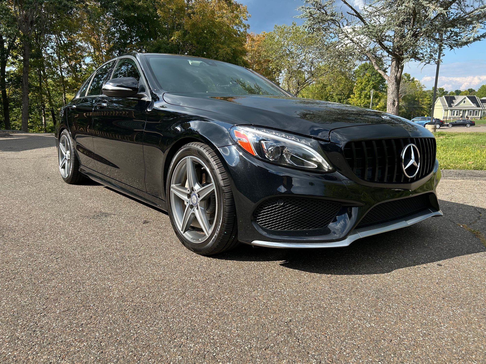

So…did a thing this weekend, traded the C400. Decided after 9 years of ownership, time to move on. Bittersweet, because I loved it. This car checked all the boxes for me, and still looked like new 10 years later.
@CaliBenzDriver appreciate all the technical insight, was very helpful!
@MatthewJ best of luck on the maintenance!
Will post a few items in the marketplace that I never installed, or removed prior to trade.
