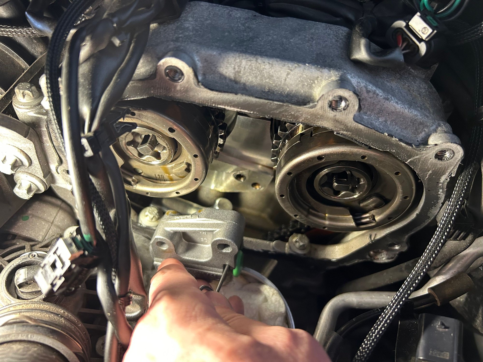

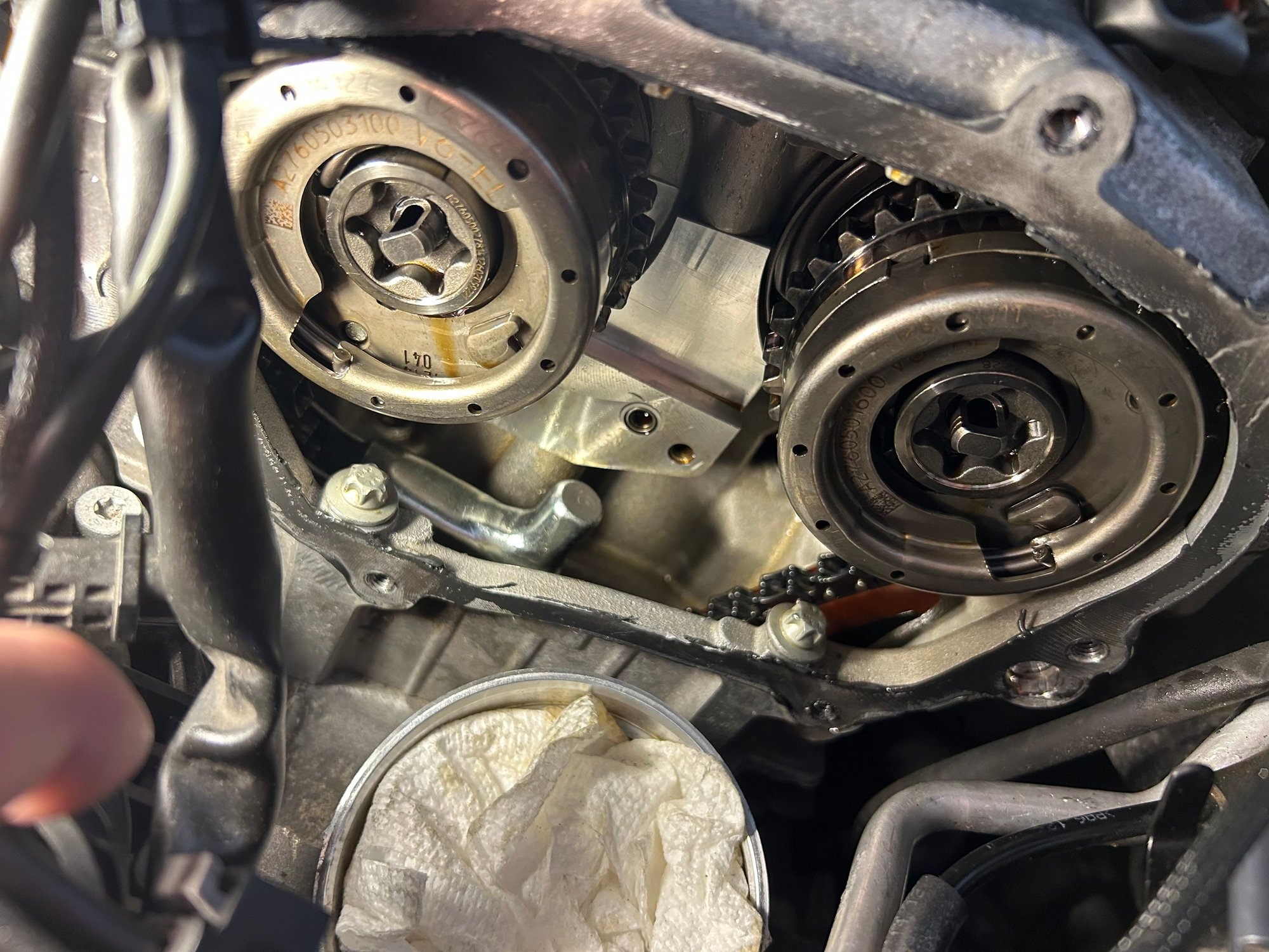

Rotated the crank to 40 degrees. I replaced the passenger side tensioner, seemed to go just fine.
On to the driver side, removed the tensioner bolts, it got jammed in the gears when it popped. Finally got it out. However, trying to put the new one in, the arm that the tensioner pushes against is way to the left, making it impossible to fit the tensioner. Thinking that was the reason it was hard to remove the old one.
Thoughts here? I believe the timing should be at 40 degrees for the drivers side too? I’m afraid to rotate it without the tensioner. Thanks!

Just to follow up. I found a few articles that indicate you can rotate it with the tensioner out. So, rotated 360 degrees. It dropped right in! Rotated it a few more times, all the timing marks seem to line up. Covers back on, just need to remount the intercooler and add oil, and should be all set. Fingers crossed!
I also did the oil solenoid mod, so hopefully I’m good to go for a while.

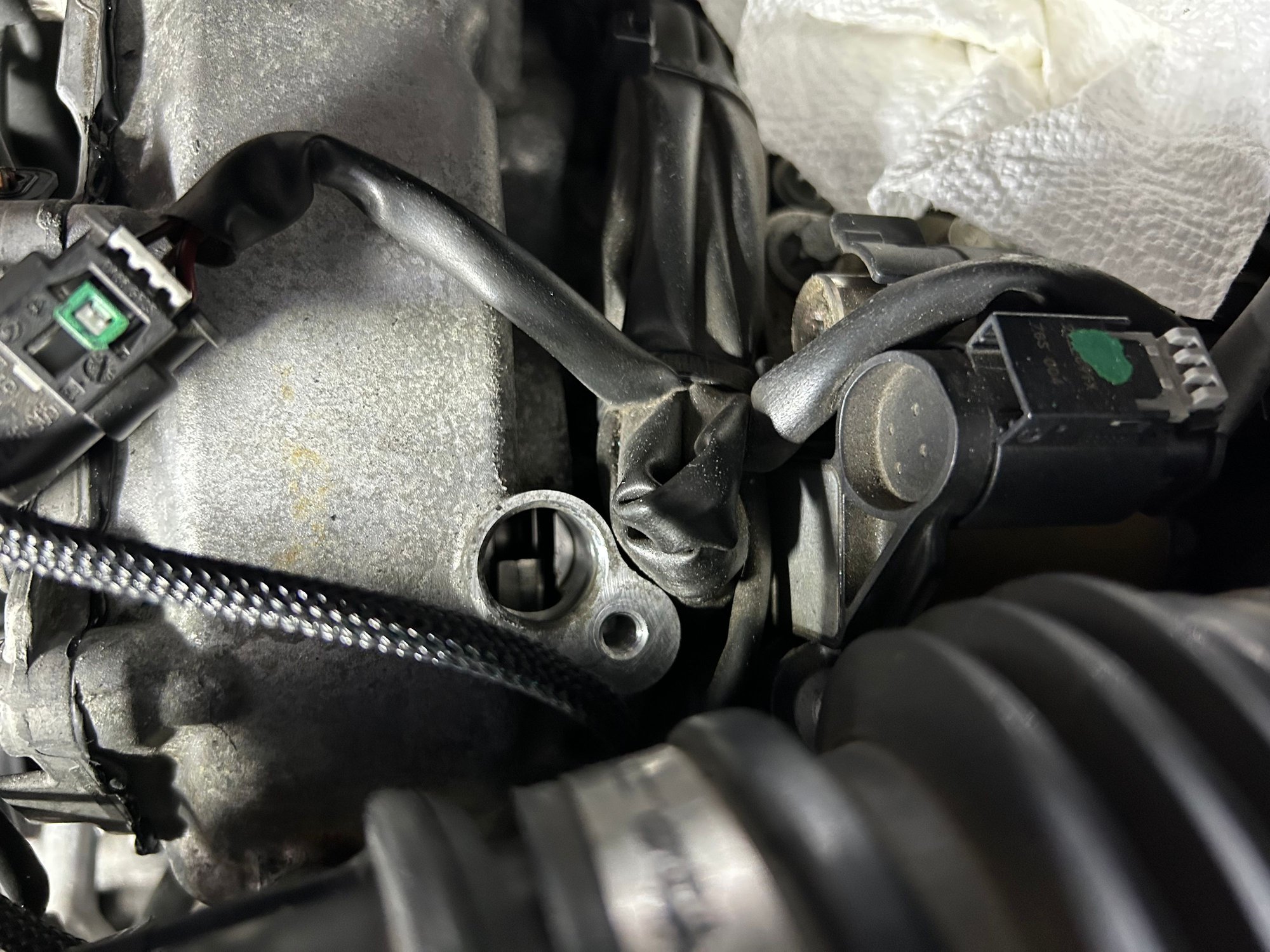

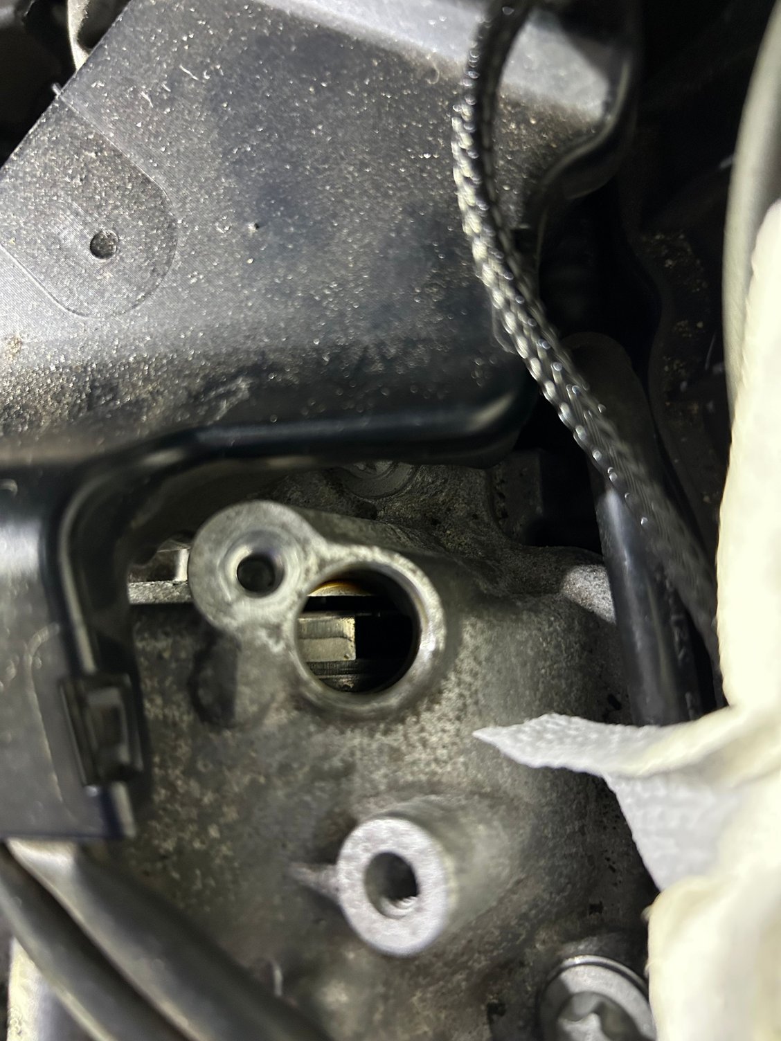

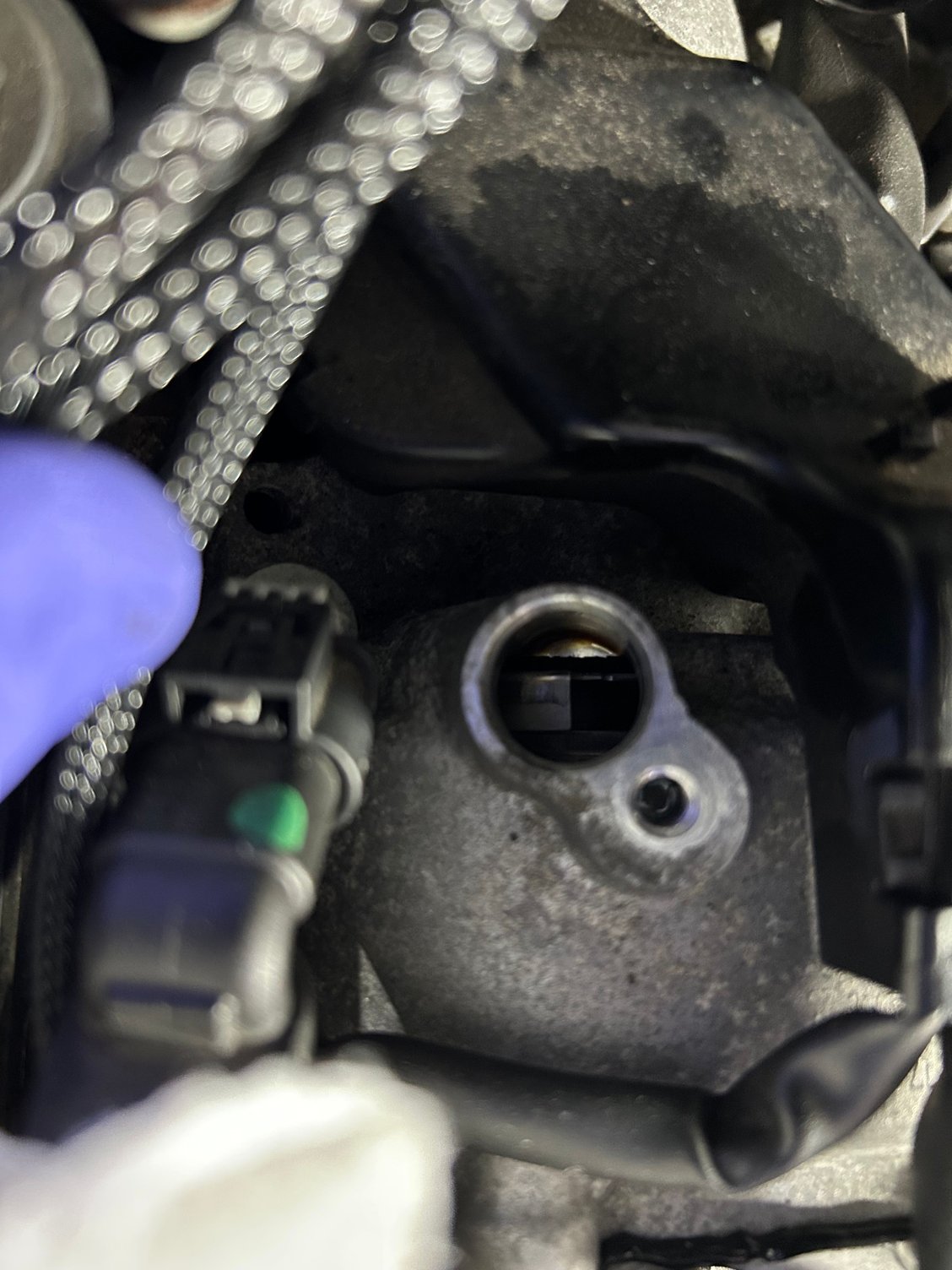

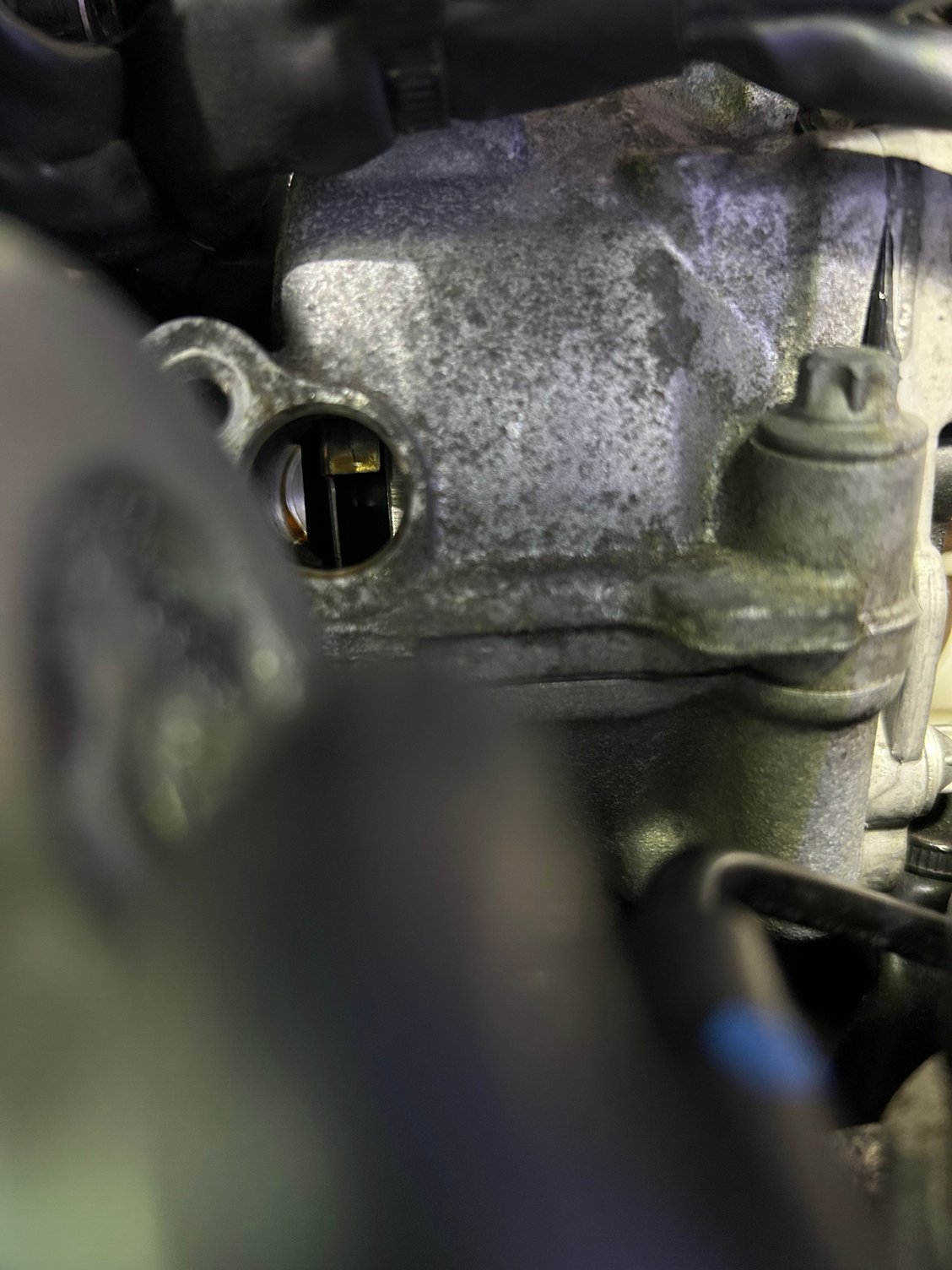

Hey Matt. I let the sealant cure overnight, so first start was tonight. Very loud rattle on start up, then cleared up. Restarted a few mins later, no noise. I plan to start in the am. I think that will be the true test. New Motul 5W-40 oil and MB filter. Also did the oil solenoid mod.
I did take pics of each of the cam positions while the crank was at 53 degrees…they all look good, maybe the passenger side exhaust is slightly off. Was hard to get a straight on pic.
Here’s the pics, starting from passenger side exhaust, intake, drivers intake, exhaust. I’ll post the videos too.

I double checked this pics....
I see passenger/Bk1 EXH is messed up
I see driver side /Bk2 is all spot on time.
The shortcut is to look at positioning live while engine is at 650.Rpm idle and 1k. Rpm...
Let's try to spot a wobbly VVT gear position using your scanner on ECU data.
Typically BK2-INT is the leading bad VVT
the comes BK1-INT comes in 2nd worst
then EXH adjusters.
Worned out VVT lock pins are caused by low oil pressure around 1200.Rpm

Old Aug 25, 2025 | 08:20 PM
CaliBenzDriver's Avatar
Joined: Apr 2019
Posts: 11,921
Likes: 6,769
From: Silicon Valley
W212 MY'14 M276-3.5NA @75kMi
DEFECTIVE VVT SIGN
oil rushing out
oil rushing out
Oil forced out of a defective VVT Phaser is a telltale sign of it having a bad lock pin.

Interesting. So that’s driver side intake. Wish I took the same pic on the passenger side. Pass exhaust is the one where the timing mark is off in the peephole.
oil rushing out
oil rushing out
-- the first time VVT is manually rotated clockwise oil gets forced out (pic.)
-- the second time you can hear a straight snap because no VVT oil is now empty.
The forward motion is applied by the camshaft force driven by valves.
