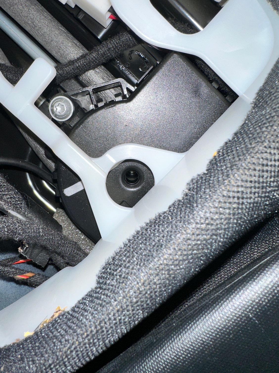

I just opened up that panel and there’s no Allen key hole. It’s just a round hole in the motor

is this cap not a plug.... ?
I'd be surprised if this did not have a manual drive for rainy-day operation.

There’s a hole in there but it’s just a hole. No spot for an Allen key to go

Plan B: use your scanner
The OCP Module let you skip-skip-skip manually when roof is de-normalized and button unresponsive.
