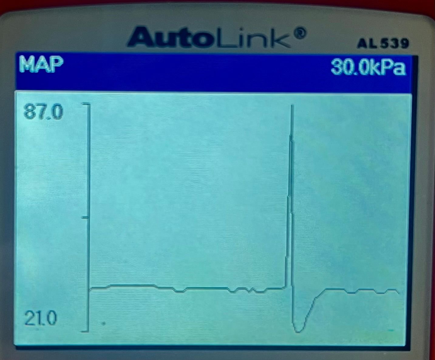

Originally Posted by p_gill
I am going to assume that you have a diagnostic tool that will show you live data.
Here is a picture of a throttle blip in my E400
Note: if your tool won’t graph the data then you can just watch it change.
Here are the key data points
1. Throttle open and air is rushing in and the pressure is approaching 100 KPa (My engine got to 87).
2. The throttle slams shut and the pressure drops below the idle value in my case 21 KPa
3. The engine gets back to idle and the ECU adjusts the throttle to get the desired RPM and the pressure is back to where it was at idle before the blip in my case about 31 KPa but it was bouncing between 30 and 33.
The tool that I used to make this measurement cost $81 on Amazon.
Note: you can also graph the pressure when the TURBO is boosting.
I think my stock E400 is somewhere around 180 KPa.
The C43 AMG will make more boost
Take care
Paul

Now that you can see the output of the MAP you are getting closer to the solution.
one thing to consider is that the diverter valve can fail in ways other than the torn membrane. The post that was linked above likely had this happen. Note: they were getting an intermittent diverter valve and not a consistently broken one
but to confirm the valve you need to check it electrically
do not give up your are going to find the solution
take care
Paul
PS if you want me to I will post a link to a YouTube video showing what I am talking about
PPS fingers crossed that the MAP sensor is broken and a new one solves the problem
