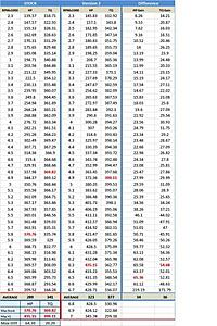

Great stuff. I put the information side-by-side so I could analyze it better, it might help out. Not sure of the nuance at 6700 (Stock Rev limiter or fuel/ignition timing), but that's where the V2 really nails it...still pulling.
I think the "Average" numbers are the most telling; i.e. area under the curve. The V2 has, on average, 34 more HP and 36 more Ft/lbs of TQ across the range. Fantastic results.
What is also interesting is the Max Difference between the two sets. Approximately 65 HP and 30 TQ. Nice job...
Attached Thumbnails v2 RWHP/RWTQ Gains v Stock Broken Down Per RPM-mhp.jpg

Did you use Excel or something similar? LOL, I've got to learn how to use that at some point.

Yeah Andy, I used Excel. Trying to help out any way I can to earn myself a discount LOL. Like the previous poster, I am torn between MHP and Kleeman only for cost and tenure reasons...however I am not making any decisions until I hit 1000 miles and MIR is behind us!
Feel free to shoot me any future data and I can do the same. (If you want the Excel file, I can send it to you via email if you shoot me your address. You could potentially use it as a template.)
I actually used the numbers last night to compare to some youtube videos. I wanted to see where the tach dropped at the bottom of an upshift and compare that to the figures. Kudos to MB for their gearing...it seems to drop right into the sweet spot of the torque at about 5000 rpms.

Awesome and thank you. Would you mind sending the file to sales@modernnhorsepower.com we would greatly appreciate it.
