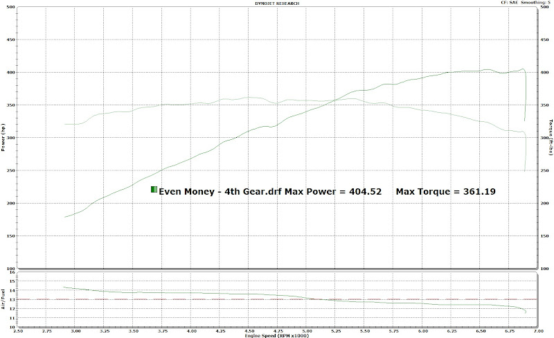

Background: Car has 10,400 miles, baseline dyno was done at about 2,800 miles. I've had the Kleeman K1 for about 2 months, 4,000 miles, before today's runs. All runs were done in 4th gear.
Mods: Kleeman K1, Charcoal Delete, Hankook V12 265/35/18
Dyno: Mustang Dyno w/ weather station
Baseline: 362 whp/361tq
Run 1: 421 whp/394tq
Run 2: 427 whp/393tq
Run 3: 421 whp/391tq
Avg gain: +61 whp/+32tq
I'm having trouble uploading the dyno graphs, can't seem to get the file size under the limit. Maybe someone can show me a shortcut, or some method to reduce the file size..

OK..think I figured it out..
Attached Thumbnails 2009 C63 Kleeman K1 Dyno-c63-k1-run-1-afr.jpg   2009 C63 Kleeman K1 Dyno-c63-k1-run-1.jpg   2009 C63 Kleeman K1 Dyno-c63-k1-run-2.jpg   2009 C63 Kleeman K1 Dyno-c63-k1-run-3.jpg

EM, it looks like the operator used a different vehicle weight for the "after" pulls. If I recall correctly, the mustang dyno uses weight as one of the inputs to calculate the right load to apply during the pulls. I don't remember if HP@50 is an input or a calculation, but either way these two values should be the same for all of the pulls.

Yeah. Thought you would notice. Although I think 3900 lbs is the more accurate wt. I'll have to call back and ask how much diff it makes. So I think if the before runs had used 3900 then the delta would have been a little less.

I'm afraid it makes a very big difference.
They owe you some more runs at the same 4200lbs weight & 11.50@50MPH inputs as your baseline.
BTW, Mustang Dyno operators have a chart/guide by vehicle they reference for these inputs so they stay consistent. I'm really surprised they did this, especially since you've been there before and should already be on file.

EM, I know the vehicle weight and HP@50 are certainly factored into the HP/TQ calculation for a Mustang Dyno. Those data points are what add "load" and simulate real world conditions. It actually makes for a great "total chassis" tuning tool, however if the values are tampered with, you can inflate or deflate results.
I dug up this old post from Mike Hornback @ Straightline Performance on LS1Tech.com talking about those inputs. It is a really good explanation/dyno comparison -> http://www.ls1tech.com/forums/11468376-post12.html
The other "odd" thing about your results is how high the numbers are. Typically Mustang Dynos read very low compared to Dynojet Dynos, but your car put down significantly lower numbers on a very familiar Dynojet:
That doesn't make much sense. It's possible this place has also tweaked their "parasitics" file to read higher as well.
Nothing smells good about this. I hope you get everything straightened out on Monday.

OK, so I called Dyno Authority, they're great and have offered to run the car again at the parameters I used before, since I still have the baseline graph. However, he said that it should only make a few horsepower difference, so we'll see. Also interesting is that they set up their mustang dyno to basically simulate a dynojet. They've had cars run on both dynos, and end up within a few hp of each other.
One more thing I learned, instead of pulling the rpm directly from the motor, they run a test at 5,000 rpm in 4th gear to calibrate the rpm readings from the roller. So in my case a slightly taller tire won't matter. Before on the dynojet, they pull the rpm off the motor and maybe the slightly taller tire, winter tire at that, affected the reading. So, at the end of the day, looks like I'm going back next week. I'll let folks know if they're intersted to come over and check it out. I'm gonna get some race gas and take with me too.
Bottom line, the car feels right, definitely pulls harder mid and top range, I'm just trying to make sure I'm getting the right readings before I go on to other mods.

OK..So I've abandoned the mustang dyno, as it is still broken after many months...and since they messed up my last run anyhow. I'm over at a dynojet that most folks here on the forum use in this area. They know what they're doing, and it's a consistent dyno. You can see my dynojet graph above, I'm at about 405 whp, and mid 360s on the torque on both winter tires and drag radials, so the figures seem reliable. The issue is, is that the whp is about 15 to 20 whp less than what I should be getting. After talking to Klemann, they verified the file is 100% good to go and suggested cleaning the MAF.
1. Got some MAF cleaner from Autozone, going to give that a shot.
2. Will order some pipercross foam filters, and see how they work.
Will hopefully be on the dyno on Sat., will see what their schedule is, to verify these potential fixes.
At the end of the day, I'm not too concerned, as I'll be getting the MHP longtubes in about 4 weeks..But if the MAF is dirty, at least it'll be clean, and I've heard good things and recommendations about pipercross, so that can't hurt.

Taking your baseline mustang dyno (with a grain of salt) your delta gain was ~43rwhp, which is on par with K1 tuning.

don't worry about the dyno numbers, if baseline and power runs are from a different dyno (even on a different day) could skew the results in either favor. It's the gains are that are important and in your cars they are quite obviously positive, so don't sweat over the actual numerical values as they do not mean much from a mustang to a dynojet. Enjoy the car.
