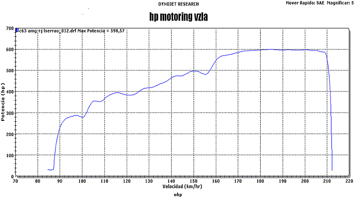

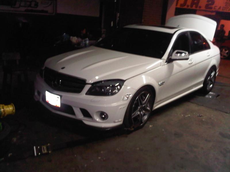

powerfull c63 vzla 598whp
like to present our c63 highway killer project .... with a little dedication and work, we have found some beautiful numbers
hpmotoringvzla
in a few days hope to move the thin line of 600whp

OMG 598WHP !!! it looks like i need to get some of these.

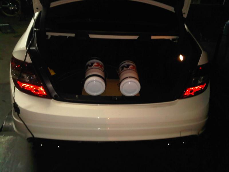

My current mods are:
-Renntech stage 3 Tune and Renntech Carbon Fiber intake
-Evosport sport pulley
-Modern HorsePower Intake thermal gaskets and lower temperature Thermostat
-Kleemann K3 80mm Throttle bodies
-MBH Custom Long Tube Headers with cats deleted, but stock resonator and mufflers
-2 NX wet Kits

Ok, when we tested the car on the Dyno, without race fuel, we had only 95 octane gas, the numbers without the nitrous are 464 rwhp.

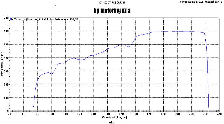

1. Kit 1: 100 hp shot
Kit 2: 70 hp shot
2. Sorry, we don´t took a video of the car on the dyno, I forgot the camcorder at home.
