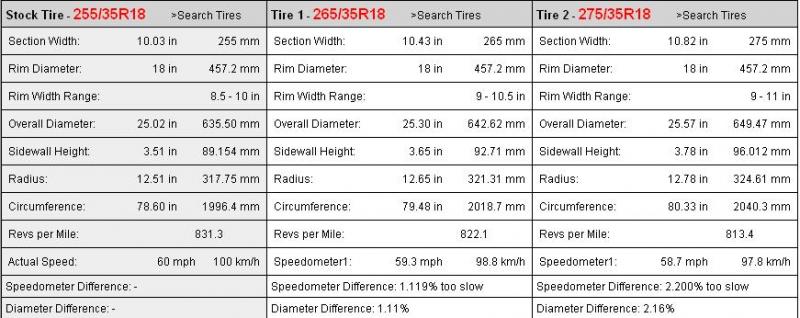

Wider tires are going to mess up the speedo quite a bit
It doesnt' mess it up anymore than how the BMW speedos come outta wack from the factory.
Miles will accumulate slower as well
