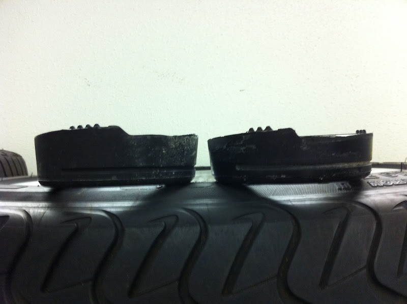

3) I also read about different springs pad to adjust the height in the rear... can someone explain... are the different pads included with the H&R springs?

3. springs don't come with any pads. I used the stock ones just make sure to grease them up with some white lithium if you reuse or change them. Not sure where to get them and what difference they would make or even why different sizes exist.

3. You can buy pads in different thicknesses so you can adjust the rear ride height a little. Superlubricity posted on this here: https://mbworld.org/forums/c63-amg-w...010-c63-2.html

Edit: I prefer the look with the spring pads #4 (part number A 210 325 04 84)... where can I buy this online?

What are 17mm spring pads?

^^ This is what the 17mm spring pads is (from superbublicity post):
Forgot to post this photo of the Spring Pads.
On the Left, Pad #4 (Part # A 210 325 04 84) - 17mm
On the Right, Pad #3 (Part # A 210 325 03 84) - 13mm <- This one is standard on the C63

The larger spring pads will help even out the H&R drop in the rear cuz our car sits a lil lower in the back to begin with.

Camber bolts are only for the front. If you have too much camber in the rear you'll either have to lift it a bit with spring pads or go with dog bones. (Notice you can tell which spring pad you have on by counting the numbs.) H&R claims stock alignment can be achieved without additional parts. Having pumped $5k in the suspension of my 996TT, I'm a bit hesistant just to slap springs on the C63 and hope for the best.
