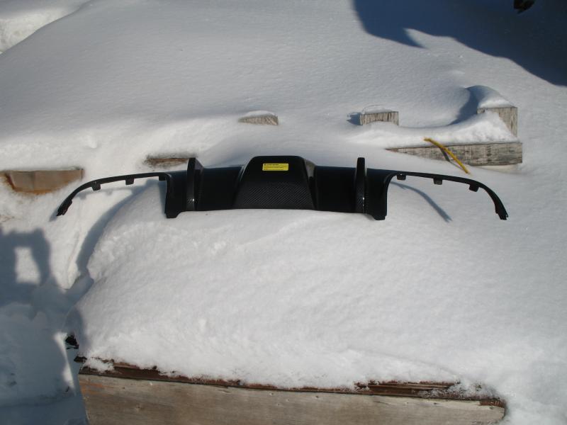

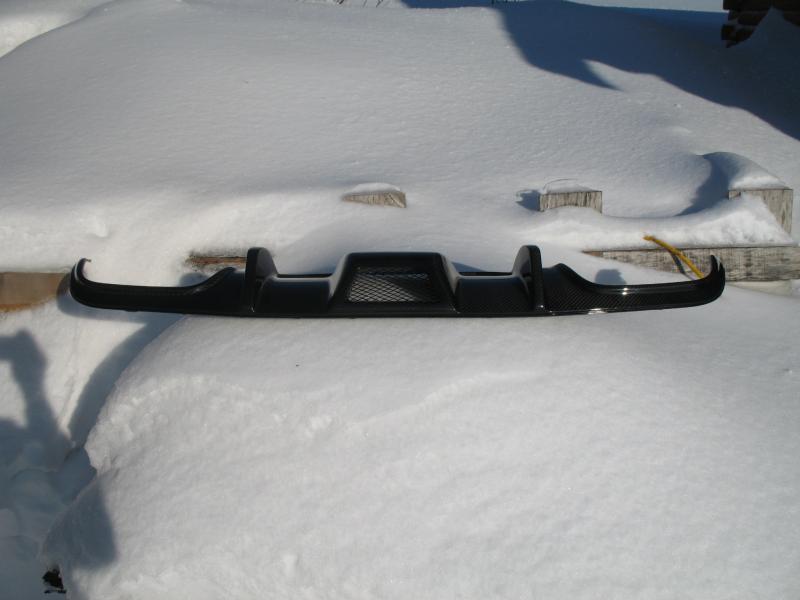

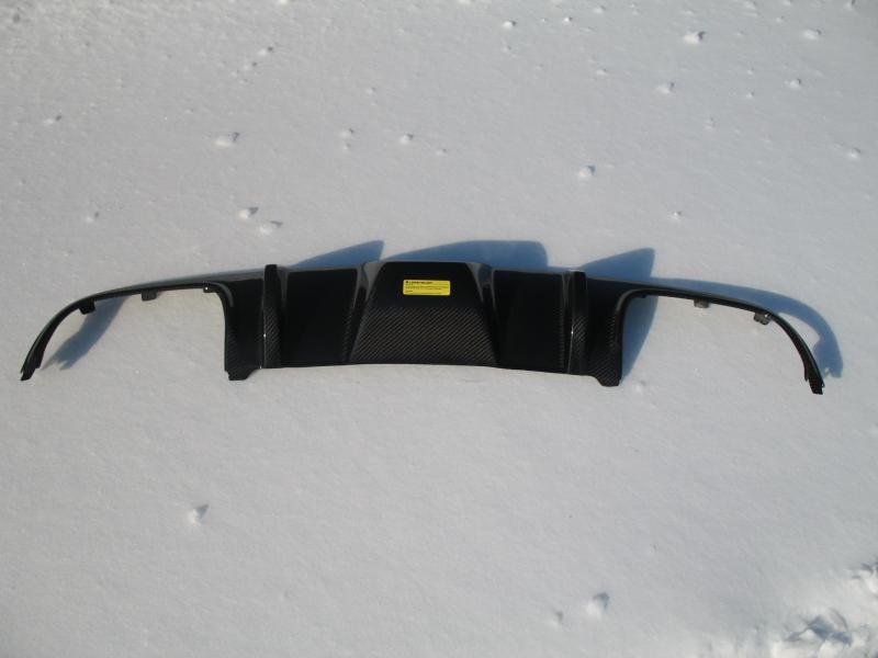

Amazing what you can find in a snowbank...

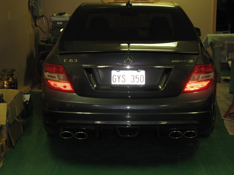

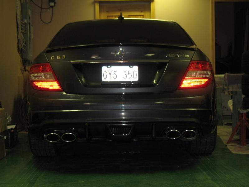

Somehow I found it attached to the back of my car.
This piece is great quality. It was a little hard to get the center tabs to insert into the slots because the studs that hold the top of the grill in hit the metal bar behind the bumper cover. The bumper cover is too flexible and the tabs just pushed it back until it hit the bar and couldn't go any farther. I had to get a little inventive. I rolled too small towels up and stuffed them between the bumper cover and the bar to hold the cover out far enough I could push the diffuser tabs into the cover. Then grabbed them by their tails and pulled them out. I tried just one in the middle but it caught on the edge of the grill and bent it so I had to find another way and placed one to either side of center to get the job done.
