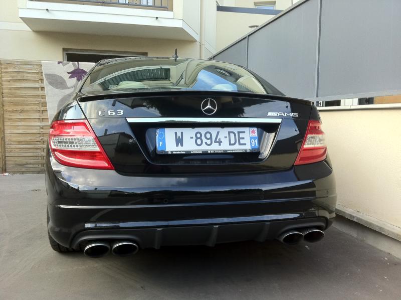

Welcome....!
But just out of OCD-ness are his AMG and C63 emblems not on lined up right on the rear of the car? Maybe its just me...

The emblems on his trunk are lined up different than the ones on my car. Guess its not just you...LOL

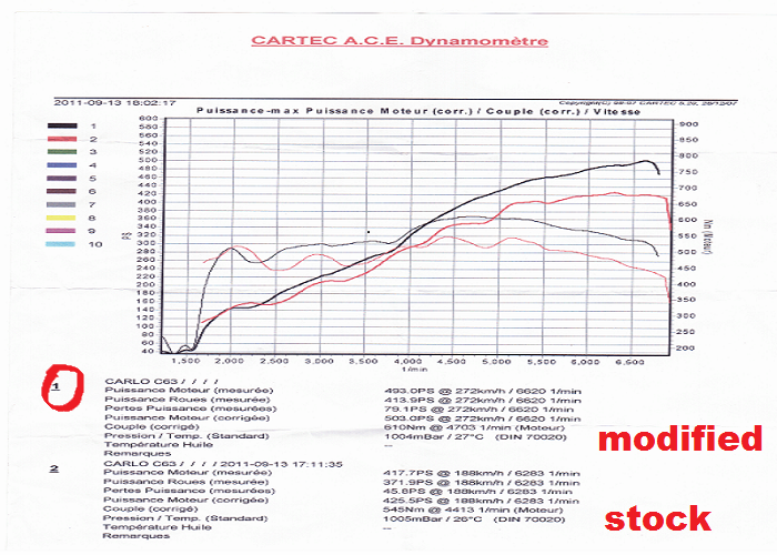

test dyno
Test makes in 5 speed
Power to announce amg origin 457 cv Verified In wheel 425.5 cv
power after modified 503 cv in wheel
power gain 77 cv very good.
Too much power On 1 speed the esp<Skated> Is crazy Flash a lot .My tire Cried .
