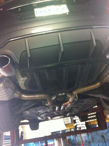

2012 C63 Coupe. Eurocharged, Charcoal Filters Removed, R-S3 Tires
Finally!!!!!!
Finally I found the solution for my squeaking and rattling noise in the dashboard.
I replaced my resonator with straight pipes. The sound became brutal and you just don't here anything else even if you want to!!!!!!!

Originally Posted by NovA_S
Finally!!!!!!
Finally I found the solution for my squeaking and rattling toise in the dashboard.
Post some pics and vid of your res delete.
Unfortunately I don't have any video yet as to iphone a video where you want to show sound makes no sense due to pure sound quality. I have semi-pro video camera just need some time to do the video.
Bellow are the pictures of what was done.

Old May 24, 2012 | 04:02 PM
  #188
Sincity's Avatar
Joined: Feb 2003
Posts: 5,983
Likes: 21
From: Vegas and Vancouver, BC
^ Looks like the shop does quality work.
