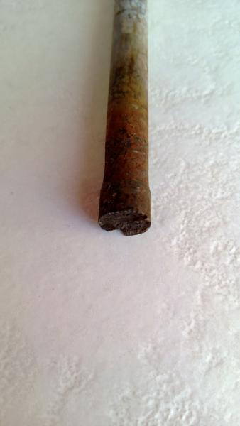

An update: statepkt is sending me some faulty head bolts. motoman and I in our own separate ways intend to bring some real information to the issue of "why" via "real-science lab testing." We're going about it in different ways so the results will be out there at different times but they'll be coming. We need more corroded head bolts from different M156 engines though, so any of you who have them around and can part with them, well please PM me or motoman...much appreciated.

They came today, thanks again state!
Attached Thumbnails M156 head bolt problems-m156_hb_1.jpg   M156 head bolt problems-m156_hb_2.jpg   M156 head bolt problems-m156_hb_3.jpg

Ugly...!

Very interesting shot of statpkt broken bolt. Severe pitting looks like water soaked, not crevice corrosion. Perhaps "soaking" is due to age of car, 2007? Water or depleted coolant driven by system pressure past the "unsealed" threads in the bloc. We are close, I hope, to professional analylsis.

^2007 w/ ~58k on the clock when this happened

Safe to say, SOMEONE ****ED UP AT AMG. lol that is disturbing to know those bolts hold your engine together. Must be a supplier, metallurgy problem.
