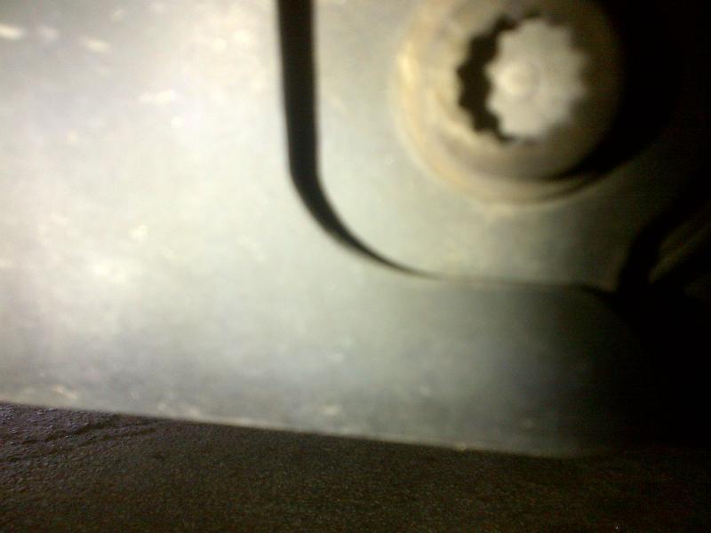

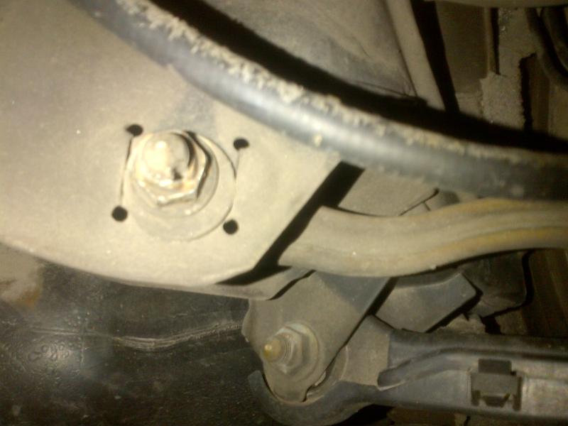

There is rear camber adjustment on our cars, I've adjusted already

Please tell me were it is and take some pics. Even the dealer tell me their is no rear camber adjustment (just toe).

Sure, no problem. I'll put it on the lift tomorrow and snap a few. I wouldn't ask your dealer, ask one of the techs

Check

There you go bro....the first pic is the one with the type of adjuster. I believe its a M10 or M12 size...that one is for the toe adjustment. The second pic shows the camber adjustment eccentric bolt. You cannot see the front of the bolt in this pic, its hard enoug to get your M10, let alone my cell phone, but its the same as the toe bolt on the head. Now keep in mind when you make this adjustment its a little tricky to reach, you need a flex head wrench and a M10 or M12 socket head. Very tight!!!
