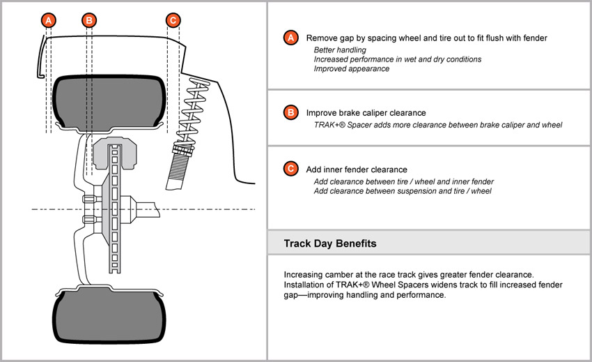

Hubcentric spacers are very safe as long as you get they from a reputable supplier.
The H&R Trak+ spacers lock the wheel and hub. I ran 10mm hubcentric spacers with longer wheel studs upfront with no issues or virbrations and they were perfectly flush without negative affects on cornering or speed.....just tryin to dispell some myths

I run 12mm in the front, 10mm in the back. Had them on lowered as well as stock height. At stock height they do not make the car look like a hot wheel, it is in fact the opposite because whether you are lowering or spacing it is filling up the wheel well and you are seeing less of it. 10 is about as far as you want to go, but 12 up front still leaves a little room.
I have always said that when showing off their new cars always do 3 things. Lower, tint and spacer. If you look at print ads for everything from a Honda Fit on up. When LFM and I went to the unveiling of the RS5, Audi had put 20mm spacers on it. Never said this before but they were pretty hot looking?!?!?
As for safety and engineering everybody has to make the call they are comfortable with. 10mm of spacer on either side of your car adds .85 of an inch. Total. We have a wider track than a regular C, and the black series has a wider track than us. Personally, I think the .85" falls within some zone of tolerance. I have used them on several cars, on several track days, and never had an issue. Mind you I have always used the H&R widetraks. As mentioned prior, they come with bolts. I think that if there was any danger of bolts shearing off or anything like that, H&R wouldn't sell them. Not because of conscience or anything, but rather fear of litigation where payouts would dwarf profits on such a cheap item.
