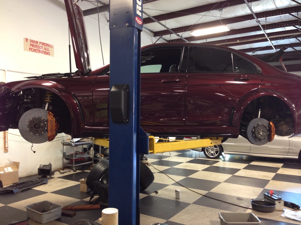

QUOTE=Dads C63;5484019]This is a new thread to delete the old "Brembo brake package" thread so I'll give you an update.
I was looking for the most cost effective way to convert to Carbon Ceramic brakes without spending a fortune. I inquired a few of the major brake builders like Brembo and Wilwood. They all wanted a fortune so I thought about experimenting with the stock OEM CC brakes that come on the new 2012 E, SLS, and CLS AMG's. Ordered the front right rotor to make sure it fit and it did. So then I ordered the caliper and it fit but needed a spacer to move the caliper out to fit the new larger rotor(made sense).
The only challenge that surfaced was the 18" wheels will not fit over these. I then inquired HRE to custom make some 19" wheels to fit over these brakes. To my surprise HRE said they could not and neither could Forgestar, Forgeline, or Rennen so I began to think this project was dead.
I have to stick with 19" because the Hoosier R6 tires do not come in a 20" for road racing and that was the whole(sole) purpose behind the CC brake conversion.
The SLS, CLS, and E all have stock 19" wheels so whats going on????? Am I stuck running a stock OEM bulky heavy wheel??
As a last resort I decided to try the stock OEM C63 BS front wheels because there was originally a Ducatti edition C63 BS that was going to have the CC brakes. That being said I hoped the C63BS wheels would fit over these larger brakes because they would need to "IF" they had the Ducatti edition(which never materialized).
Well, I got the stock OEM MB C63 BS wheels today and they fit great!!!!!!!!!!
Merry Christmas to me!!
The best news is that they only weigh 21.4#!!
Here is the progression:
Test fitting the rotor and caliper. Needs a spacer and brake pads.
Attachment 378555
Attachment 378556
Everything lines up!!
Attachment 378557
Attachment 378558
Spacers:
Attachment 378559
Attachment 378560
New OEM C63BS wheels:
There is plenty of space between the caliper and wheels. What you are seeing is the stock caliper hanging behind the new CC caliper.
Attachment 378561
Well, there you have it. The stock OEM AMG CC brakes for the E, CLS, and SLS can be adapted to our little "c".
The rears are next.
Part of my dilemma - do I leave the new wheels silver and gray as they are as a contrast to the dark color car or have them painted gloss black?? I will purchase the rear wheels to match and have them widened to accomodate the wider tires.[/QUOTE]

Okay guys, its official. You can do the rear conversion and its actually easier than it sounds. However, it takes a few more parts. The only other downfall is that the hub extends out approximately 1-3/8" further than our stock hub so you will need new wheels on the rear also.
For the rear you will need:
Left and right calipers, CC rotors, and pads(given )
In addition:
Left and right wheel carriers.
Two rear "E" series axles.
Two rear flanges (part the wheel bolts to)
Rear emergency brake assembly and shoes(both sides are in the package)
The stock wheel carrier unbolts and the new one bolts right back up.
The rear axles actually just pull straight out and back in. Do not have to touch the rear end. Then the new hub bolts to the new axle.
Everything else just bolts up as normal. It all looks beautiful!!
Attachment 378473
Attachment 378474
Let me know if you have any questions. The rear is actually easier but requires more parts. The front just needed the spacer. There you have it.

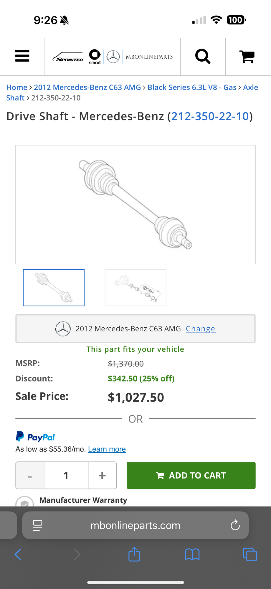

Could anybody help me with the part numbers for the above list of Dads C63 for the rear?
Are these E-Series Axles and parts from a standard E-Class or should it be from a E63?
It would be very nice if someone could help me, my friend will change also the rear brakes to Carbon Ceramic.

It's from the e63.
It's showing part number 212-350-22-10
it's only showing the one but also says that's for the left so not sure what's up with that. Here's a list of other vehicles the same axle comes in incase you are looking for used.

Originally Posted by deadlyvt
It's from the e63.
Ok, the axles / drive shafts are A2123502210, they are also in standard models, if I'm correct.. 🤔
Could you help me also with the other parts?
- Left and right wheel carriers.
- Two rear flanges (part the wheel bolts to)
I have to check everything from used parts maybe..🤔
