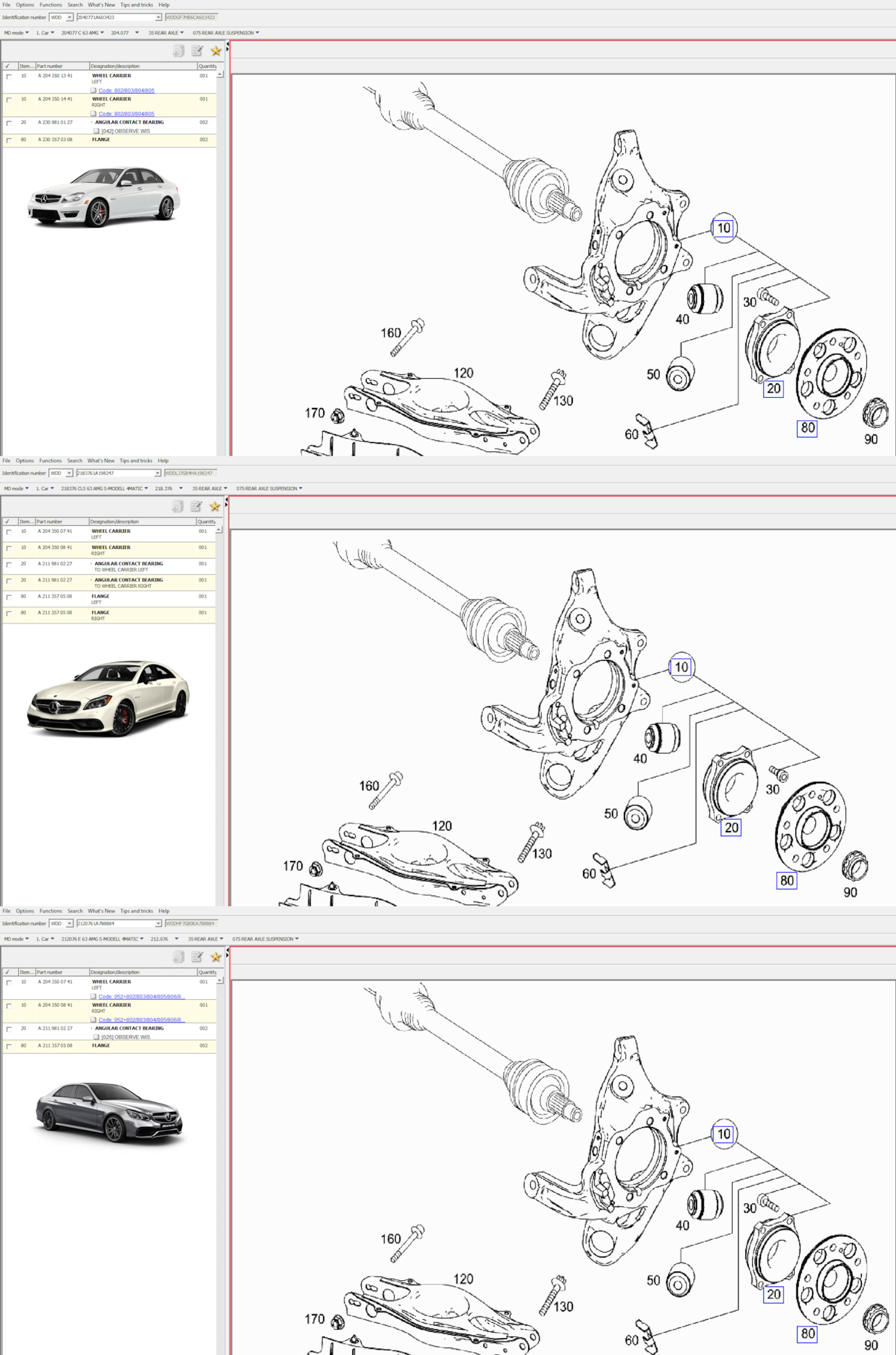

I would start with the wheel hub and bearing replacement. From what I see in the parts catalog that might let you fit the rear rotors and drum directly. The entire wheel carrier is just slightly deeper on the W212 and C218. So what I would do is buy ONE entire used wheel assembly for 120€ from a W212 and test fit just the bearing and hub. You just remove the rear FOUR E12 TORX and it pops off. Test fit it. If the S204 can accept the drum, caliper, and carbon ceramic rotors with correct fitment then just order the bearing and hub. You might not even have to change the axles and save on a ton of labor.
C63 rear rotor is 5mm shorter than W212 and CLS63. So 10mm total is minimum added to axle width.
C63:
  • A2043501341 Left carrier
  • A2043501441 Right Carrier
  • A2309810127 Bearing
  • A2303570308 Hub
CLS63 / E63:
  • A2043500741 Left carrier
  • A2043500841 Right Carrier
  • A2119810227 Bearing
  • A2113570508 Hub

Thank you very much for your help. I will discuss that with my friend.
