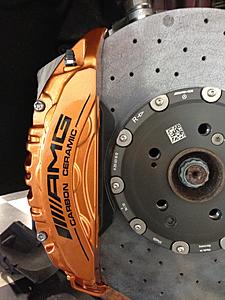

Test fitting the rotor and caliper. Needs a spacer and brake pads.
Stock OEM MB Carbon Ceramic Brake Conversion-d0abaa75-7604-46f8-ad65-12fcddf9cf92-1397-000000764a107e0c.jpg
Stock OEM MB Carbon Ceramic Brake Conversion-750bf1a1-7a9e-4511-92b2-017300bf51e7-1397-000000764656e09d.jpg
Everything lines up!!

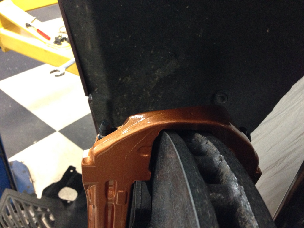

Spacers:
Stock OEM MB Carbon Ceramic Brake Conversion-33682242-6efa-4c28-97b3-ea2b2fcfe872-14232-0000058ef02e1ef1.jpg
Stock OEM MB Carbon Ceramic Brake Conversion-b2b231a5-3d78-4661-bd78-90d788aeb807-14232-0000058ee5835c43.jpg
New OEM C63BS wheels:
There is plenty of space between the caliper and wheels. What you are seeing is the stock caliper hanging behind the new CC caliper.
Stock OEM MB Carbon Ceramic Brake Conversion-da6289a4-bd70-44cd-b750-0024885ca887-23727-0000096bb39bd8d2.jpg
Well, there you have it. The stock OEM AMG CC brakes for the E, CLS, and SLS can be adapted to our little "c".
