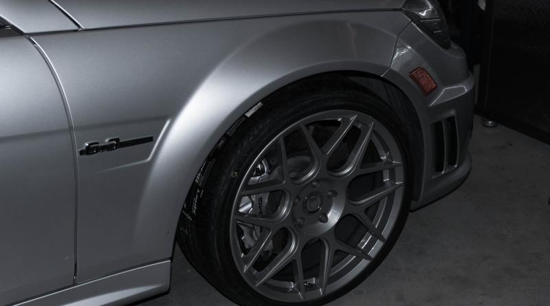

UPDATE
Alright gents, Had some time to get the tires mounted today. Rushed out of the office early and test fitted one of the fronts!
Thanks to my friends @ Tires23 for the always speedy and meticulous work. They truly are an enthusiast shop. Good bunch of guys!
The wheel looks great, and of course mounted up with no issue. Tires spun free no issue with rubbing on the inner side of the suspension. The big question is how flush are they with the fender. Its pretty damn close!
The real test will be after I put in the Coil overs. It will be a close call. But I definitely think its doable!
Either way here are 2 quick shots.
Kris

The fitment looks really good! Good job!
As for the color, u should have went gunmetal.. I find ur color choice blends too much with ur silver car & silver calipers. Might look better once u install all 4.

Lowering the car will give more negative camber so it might work
That does look aggressive though.

Nehh, I like this combo. I had a similar setup on my last car as well.
Don't really like gunmetal too much, it looks like its covered in brake dust all the time. Dont like black wheels either. So here we are

I hope to have in suspension installed in April some time.
At stock height this setup will work without issue. I can confirm that.
Its extremely flush, I may have to roll the front fenders just a bit to get a little extra clearance. Lets see. Right now I'm amazed how well they look / fit on the front.

I had 8.5x19 ET28 with 225/35/19 and it was undriveable at the lowest coilover setting.
Later I changed the spacer and switched to ET33 and was much better but still had occasional rubbing issues on larger dips.
So I wouldn't the lower the car to the max if you don't want to damage the fenders.

If I lower the car too much It will be extremely tight to the front fenders.
Matt have you considered rolling your front fenders to gain a bit more clearance? I'm thinking about doing it front and rear just to make sure.

I have access to a fender roller. I did all of my other cars without and issue. Think I will roll the C63 as well.
And LOL about the fender rolling it self I know exactly what you mean.
If I can get a camber plate, maybe I can ad just a little bit of negative camber to the front, maybe a degree or 2.
