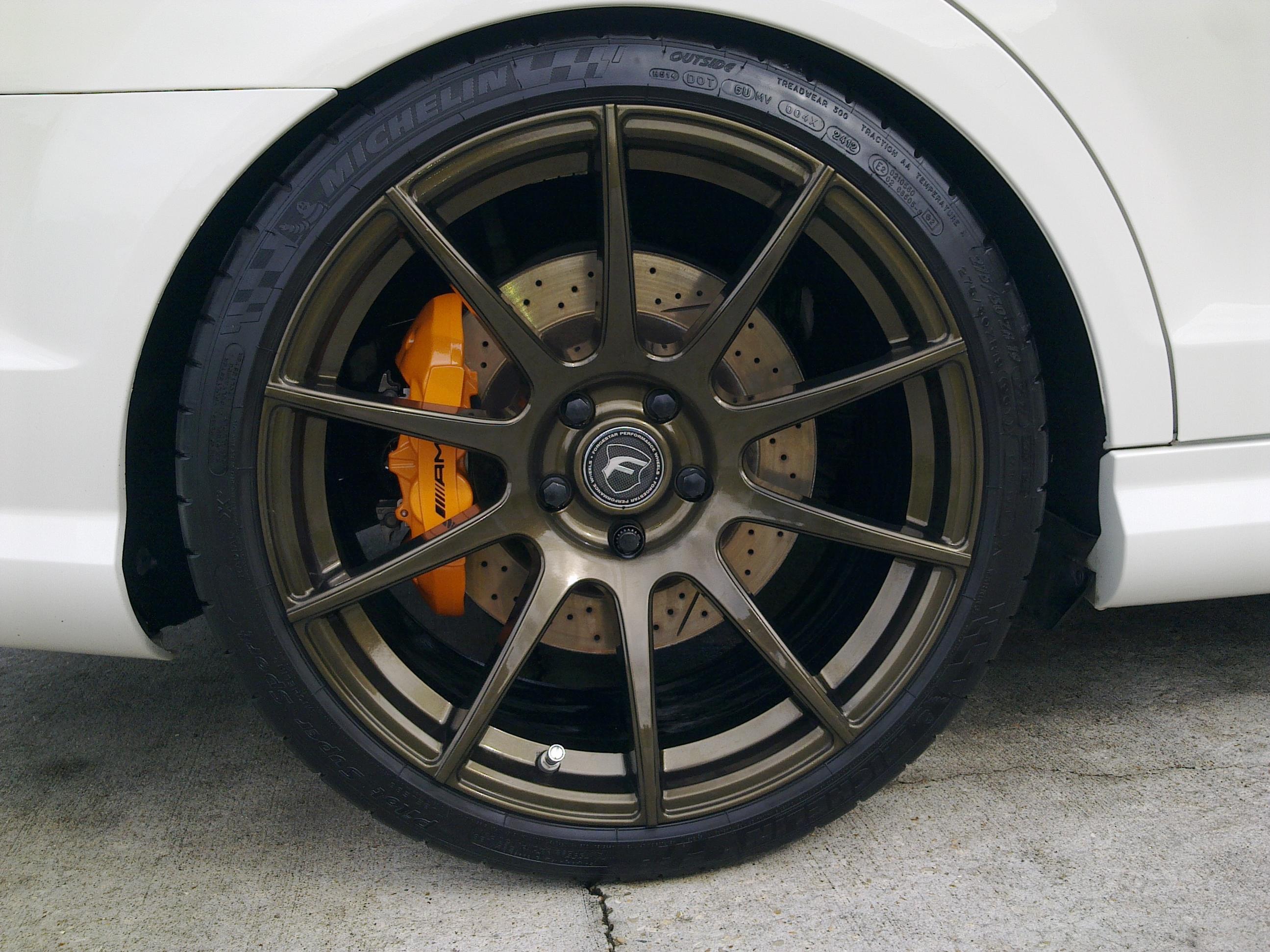

Mar 12, 2014 | 04:24 PM
Quote: Man why the hell everyone is going with the orange! It really looks bad in my opinion! Like, red or yellow are the only colors comes to my head :/ I guess each one has a taste..
Don't you like them in orange ???
Painted Brakes- PICS + little AMG Key Back Action-08242013463.jpg   Painted Brakes- PICS + little AMG Key Back Action-08242013464.jpg
Reply 0
