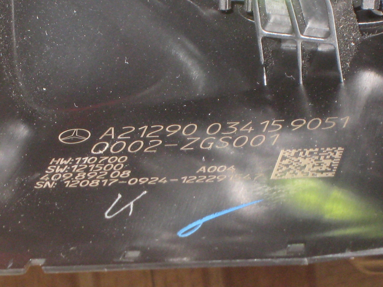

I just bought an used steering column (#A212 900 3415 9051) for 175$ and the airbag (323$) off ebay.

Old thread but to confirm, if I bought a facelift steering wheel like from a 2014 c63, I can install that to my 2011 e350 wagon by just buying and installing a colum from a facelift model?? And all buttons, paddle, lights will work with no issues? And don’t have to do a chip swap? Thanks

I decide to bite the bullet today and swap out the chip/board and it worked!!!! It was easier than I expected!! Boards were the exact same size and literally remove and replace. Then plug all the wires back in and all good to go.
Only thing is that I have an airbag error message that I have to remove. But the hard work is done!!
