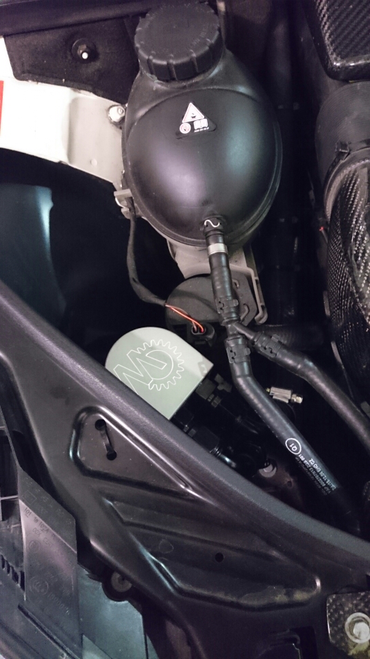

Attached Thumbnails Weistec Engineering Oil/Air Separator Group Buy 2014-mms_img1544281259.jpg
