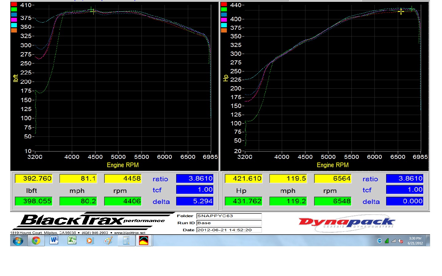

For reference, mine pretty much gave me the exact same readings, mine actually lost 2hp with the ECU Tune.
The tuned files were the RED and LIGHT Green Lines
The ones which produced the lowest numbers..

Updated with larger images
I have a 2012 P31
The ECU Tuned Runs are in Red and Light Green
The Stock Tune Runs are in Magenta and Light and Dark Blue
In my case i think my top base was 431 and my top Tunes was 429 so I actually went -2 HP with the Tune
Attached Thumbnails Finally got my baseline dyno runs in-snappy-c63.jpg   Finally got my baseline dyno runs in-snappy-afr.jpg

Okay this file actually make a little sense to me.
I think yellow is base line and green is tuned.
I think you went from 421.61whp to 431.76whp and 392.76trq to 398.055
And if you are a P31 package that is why I was thinking your original docs were a bit high on base line. Looks like on a P31 package the EX tune is worth 10whp and 6wtrq if I am looking at this correct....

Old Jul 25, 2014 | 04:18 PM
sighting's Avatar
Joined: Sep 2010
Posts: 457
Likes: 17
From: California
e63s edition 1
Well no. that was just the lowest negative. The green does not show the green line it was just where you placed the cursor. So technically the highest NON Flashed was 10 HP MORE than the lowest NON one but it was the first one so the second run was more inline.
This was how i ran it.
First run was with ECU flashed
Second run was with it removed, they were almost identical/
Third and Forth run was ECU flashed
Fifth was ECU Stock.
So actually my best flashed was -2 i think. vs my best Stock
So in short they were pretty much identical
Wich is inline with the OP's numbers and conclusion,
I don't have the RAW file anymore, i can't find it but the only difference is that i think i found the correct gearing ratio for the gear which is 3.861 and not 3.88 so maybe that adds the +7hp i have over his.
The top Torque was the light blue line - Stock
The lowest Torque was the red line - Tuned
The top HP was the Light Blue line - Stock
And the lowest was the light green line - Tuned
