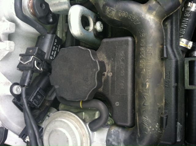

Been a month since I had my C63, loving every minute of it. Since this is my first step into the AMG world. I wanna explore and learn everything I can about my car. So looking under the hood, I noticed this reservoir contained under the engine cover. Anybody can tell me what it is? When I opened it, it was empty. What spec should it be filled with?

Buddy that's power steering

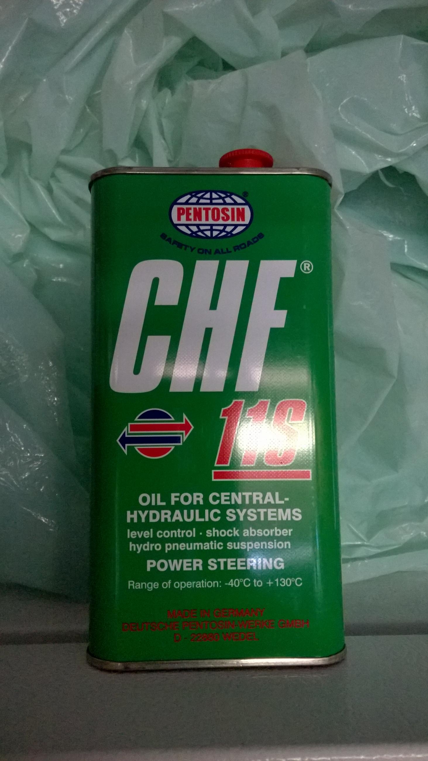

This stuff:

There's a stubby dipstick under the cap. There's no way to tell how much down the OP's fluid is but it could easily be 12oz+.

^ That's a good price from ECS on those fluids. The easy way to "change" fluid is the turkey baster method. Mine (Target @ $3) withdraws about 7oz of fluid each time. Four sessions will do it. My fluid was quite clear to begin with at 30K miles but absolutely crystal clear when I was done. I did it over the course of a few days of normal driving but if you do it in one session just remember to introduce some fore-and-aft vehicle movement at the same time as the side-to-side when circulating the PS fluid.

The dipstick has four markings - two each for hot and cold levels. I used a kitchen measuring cup with spout and simply replaced what I extracted each time. Final adjustment I did cold after not driving the car for a few days.

Don't know that rocking that car will do much, but you need to turn the wheel lock lock to lock several times to get all the fluid circulated.
So if your doing the turkey baster method, you'd want to suck out all the fluid you can, refill with fresh, turn the wheel lock to lock several times, and repeat. Ensure you don't turn the wheel at all with the reservoir drained or you'll suck up air into your system.
After your last refill, you'll want to turn the wheel lock to lock again as a final check so any air bubbles are worked out of the system.

I no longer remember the context of the conversation with my tech but it must have been about renewing the PS fluid since I've always done that as a regular maintenance procedure for my cars. He was probably trying to tell me not to go full lock for the reasons stated, hence the forward-and-back component. In general, for anyone contemplating this, a total drain of the reservoir is entirely unnecessary IMO. Just suck it out and replenish while using up one liter of PS fluid and you're done..

I exchanged mine with the baster
I put the front end on jacks
Do one full slow lock to lock each exchange
If you know
the system volume
The baster volume
And the number of times you repeat it
You can figure out the dirty fluid (or clean fluid)
Assume 20 oz volume
6 oz removed per cycle
Cycle.....dirty
1.....14/20 70%
2.....14/20^2 50%
3......14/20^3 35%
4......14/20^4 24%
And so on
The more you exchange per cycle the better
Actual system capacity is 0.8 liter

It was pointed out to me that I wasn't very clear about how I stretched out the fluid renewal. Basically I did 7oz at a time driving around normally the rest of the day, and then drawing out 7oz the following day etc. until it was done. What I would suggest though is saving 4oz of fresh fluid for the inevitable top-up later.
