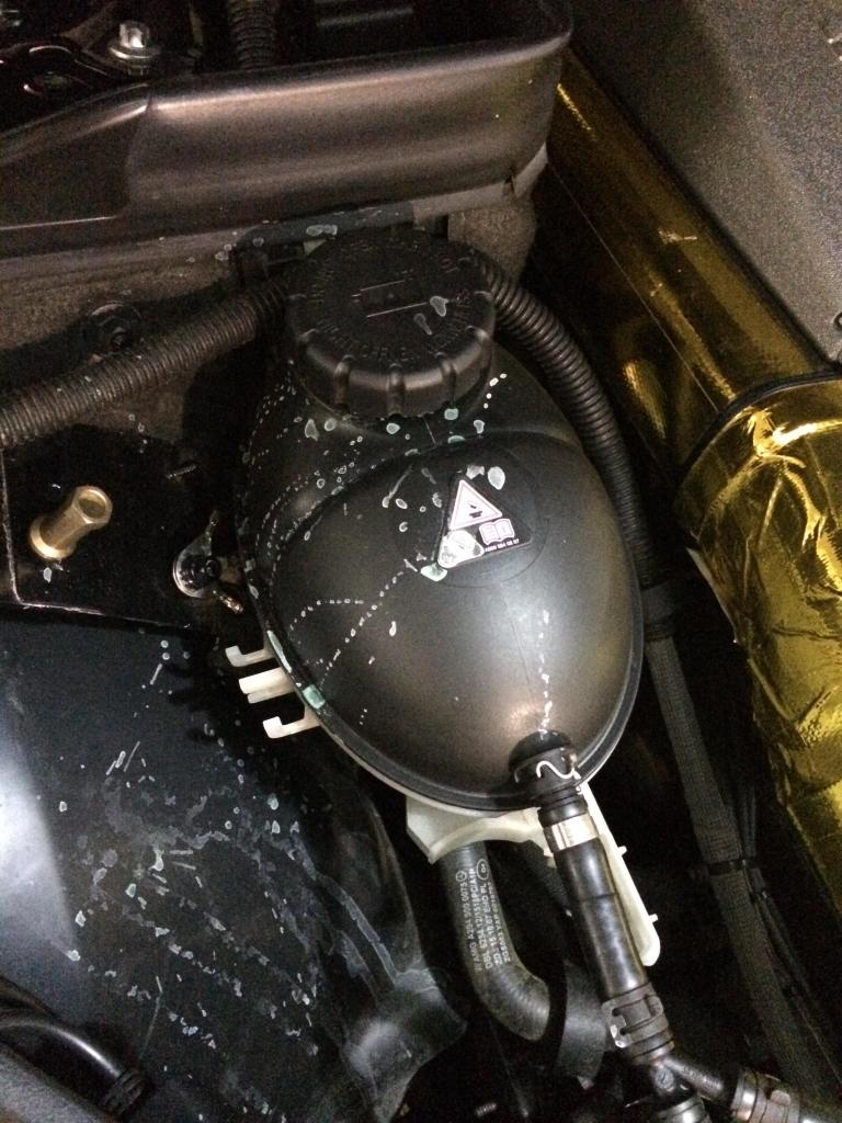

5. Started to snoop around a bit more, and found this under the hood:
Looks like my coolant overflow reservoir puked all over my engine bay at some point in either this drive or the last. I know this is brand new because my engine bay is spotless.
Driving home late last night, oil temps stayed around 217deg cruising on the highway, while water temps were anywhere from 180deg (which is the coolest I have ever seen so far), up to a not un-normal 200deg. It fluctuated back and forth up and down the whole drive - seemingly more than usual. When I got to the city and slowed down, oil temps went to 240deg, and stabilized at 230deg - 10deg higher than usual. Water temp was normal at 197deg.
So we have a CEL turning on and off, an overflowing coolant reservoir, and somewhat erratic temps.
SO... the question is does this sound like a head gasket or a misfire in the drivers side bank? Would the car throw codes for either or both? And what is the best thing I can get to read codes within reason? Many thanks guys, this one has me a little stumped...

id say either your res cap is bad or the dealership didn't tighten it down all the way if/when they checked levels. was it loose?

Yeah, I'm at my car now and the coolant res cap was loose. However the cap doesn't 'click' or catch like I'm normally used to. Is that normal? Could be a bad cap throwing the CEL? Smoke was maybe just condensation (on startup after the track session after sitting for 2hrs). Then heat issues would be caused by too low coolant maybe. Hmm will go get some distilled water and top it off then. Thx for the suggestion.

if you still have warranty, I'm sure the faulty cap would be replaced for free. of course, it's prob not that expensive either. just a thought.

Still have warranty. The cap does not feel right at all. Will prob just order one from OEdiscountparts.com. Thx.

They overfilled the coolant
Should only be 1/2 full when cold
There is a tab in the reservoir
They did mine too
Goofy temps til I siphoned some out

Ah ha there's the answer. Thanks dude.

If you have to top off the coolant use a 50-50 mix with the proper MB coolant to maintain the 15 year coolant life.
