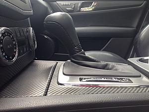

I also did the wrap over the weekend
Old Aug 18, 2014 | 08:49 AM
1REDC63's Avatar
Joined: Feb 2012
Posts: 568
Likes: 13
From: Washington DC
2012 C63 AMG
I did my gear shifter as well
I assume you mean the silver trim piece, and not the knob itself....
Old Aug 18, 2014 | 09:46 AM
1REDC63's Avatar
Joined: Feb 2012
Posts: 568
Likes: 13
From: Washington DC
2012 C63 AMG
yea I like the way the wrap turned out all together

My interior
Attached Thumbnails 3M 1080 Carbon Fiber Interior Wrap Complete - Pics Inside-image.jpg
Old Aug 18, 2014 | 03:01 PM
1REDC63's Avatar
Joined: Feb 2012
Posts: 568
Likes: 13
From: Washington DC
2012 C63 AMG
Another view
