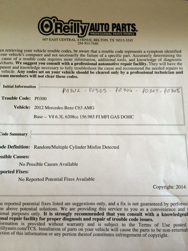

Hey guys. Auto Parts pulled the code for me.
They don't have the data for 2014 so we used 2012. I think it's the same?

Thank you. They pulled the code out it says misfire based on 2012 c63 data.

Bump for help, code p0300 p0302 p0305 p0306 p0307 p0308..

The P0300 is just saying multiple misfires and then the others are saying misfires in cylinder 2/5/6/7/8.
You're using premium gas right?

Generally misfires are due to poor ignition or fuel injection. So basically not enough sparks or fuel. I would check the spark plugs to see if there are no black residue on them. That would be your first troubleshoot step. You can try to swap coils to check if they are faulty.
For 12k miles that would be surprising but who knows. You are probably still under warranty so get the car checked/fix by MB.
Driving with misfires is not recommended because long term it could damage your exhaust system. GL

They replaced all my 8 spark plugs. They can't figure it out why but the spark plugs looks bad. Car runs good now.
