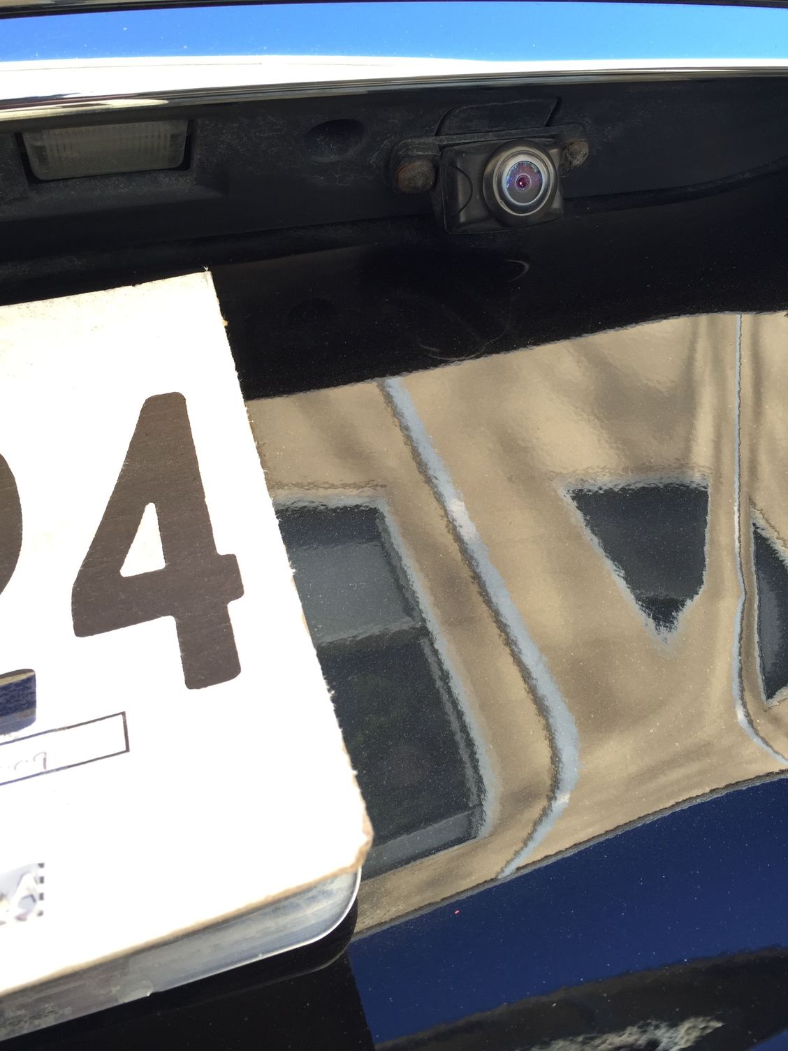

Question about semi installed backup camera.
So I just recent bout an 09 c63 and I seen where there is a camera already installed. Whenever I go into reverse I have no picture. I also have this odd long cable coming from behind my rearview Mirror. I feel like this somehow related to the back up camera because I have no idea what the cables plug into. Any information is greatly appreciated!

The camera may need repairs or possible to be turned on in a Menu or activated in the engineering menu.

So the other day I popped the trunk liner off and traced the back up cam wires all the way up to the front of the car and they were the cables in the picture I had posted before. So my guess was maybe he bought a display screen to use the camera and when he sold the car he just took the screen and left the cables there.
I checked and there is a right angle fakra cable plugged in but I'm not sure where it led.
