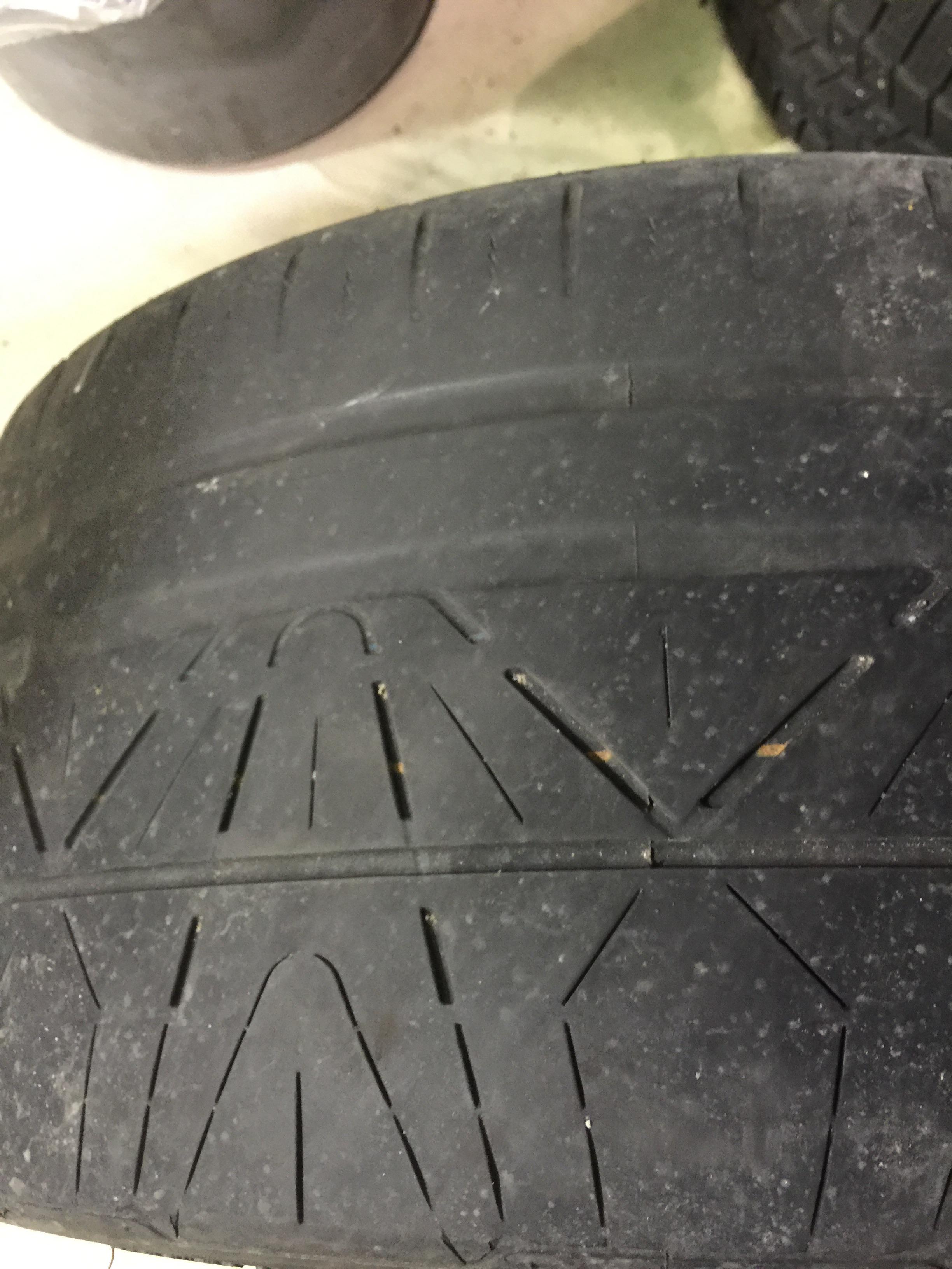

Old Nov 10, 2014 | 12:00 AM
ToXicXxX's Avatar
Joined: Sep 2014
Posts: 474
From: Calgary, AB
2011 C63 AMG P31
Try nitto invo's!
They have impeccable traction, though wear is... A bit rough.
These are mine after 6000km (275/35/18)

Old Nov 10, 2014 | 12:06 AM
ToXicXxX's Avatar
Joined: Sep 2014
Posts: 474
From: Calgary, AB
2011 C63 AMG P31
Originally Posted by Spdrcrj
I think so, 8.5" front 9.5" rear. That's what Tirerack says anyway.
I had Invo's on a C5 Z06. Hated them.....too much sidewall flex. Now NT-01's.....awesome, just don't come in proper 19" size, hence, looking to NT05's. Live in Vegas so not much rain to speak of.
Different strokes for different folks. I used only PSS before, I like the invo a lot more, especially when I'm buying a new set of rears every year for way less then PSS.
