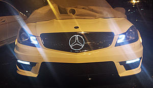

Does anyone have a photo reference of this?
Ask and you shall receive!
