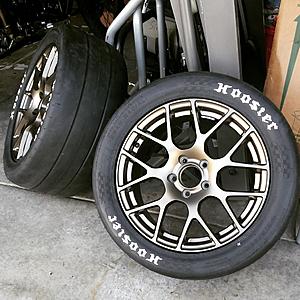

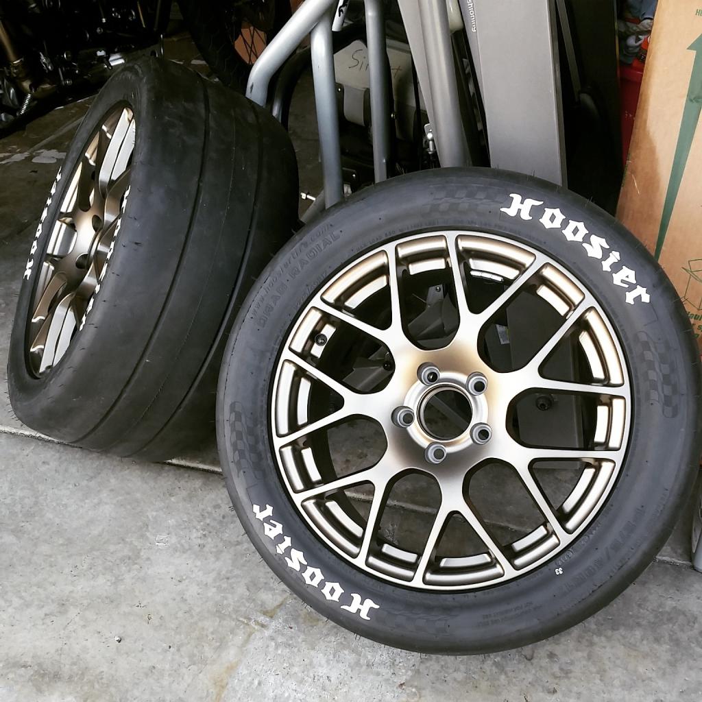

Got your solution right here...can't wait to fix my strange throttle jerking...
