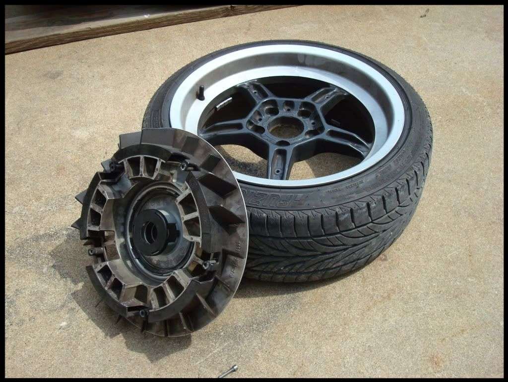

If you are in a situation where you repeatedly end up boliling the brake fluid - not because the brake fluid is three years old but rather the size and design of the brakes - the first thing you should look into is installing brake cooling ducts. On my 928GT the front brakes are 304 mm (12") on a car that weighs ~3500 lbs. It has brake cooling ducts from the factory (built in the underbody panel) and despite repeated abuse at the track I have never been able to even get the pedal to feel spongy, let alone get anywhere near boiling the fluid despite the small-ish rotor size and relativey high vehicle weight.
Not sure how easy or practical it would be to run brake cooling ducts on a C63 (on the pre-FL cars, perhaps one could sacrifice the fog lights and run ducts from there but I really don't know what's underneath and whether there is other stuff in the way), but if you were using one as a track rat where brake cooling was essential, that would by far be the first logical starting point instead of moving to bigger or CC brakes. And, if I recall correctly, there was a company making wheel covers in all common bolt patterns a la E34 M5 that attached on the outside of the front wheels and essentially acted as scoops / propellers to cool the brakes (see pics below). Not exactly pretty but certainly functional.
