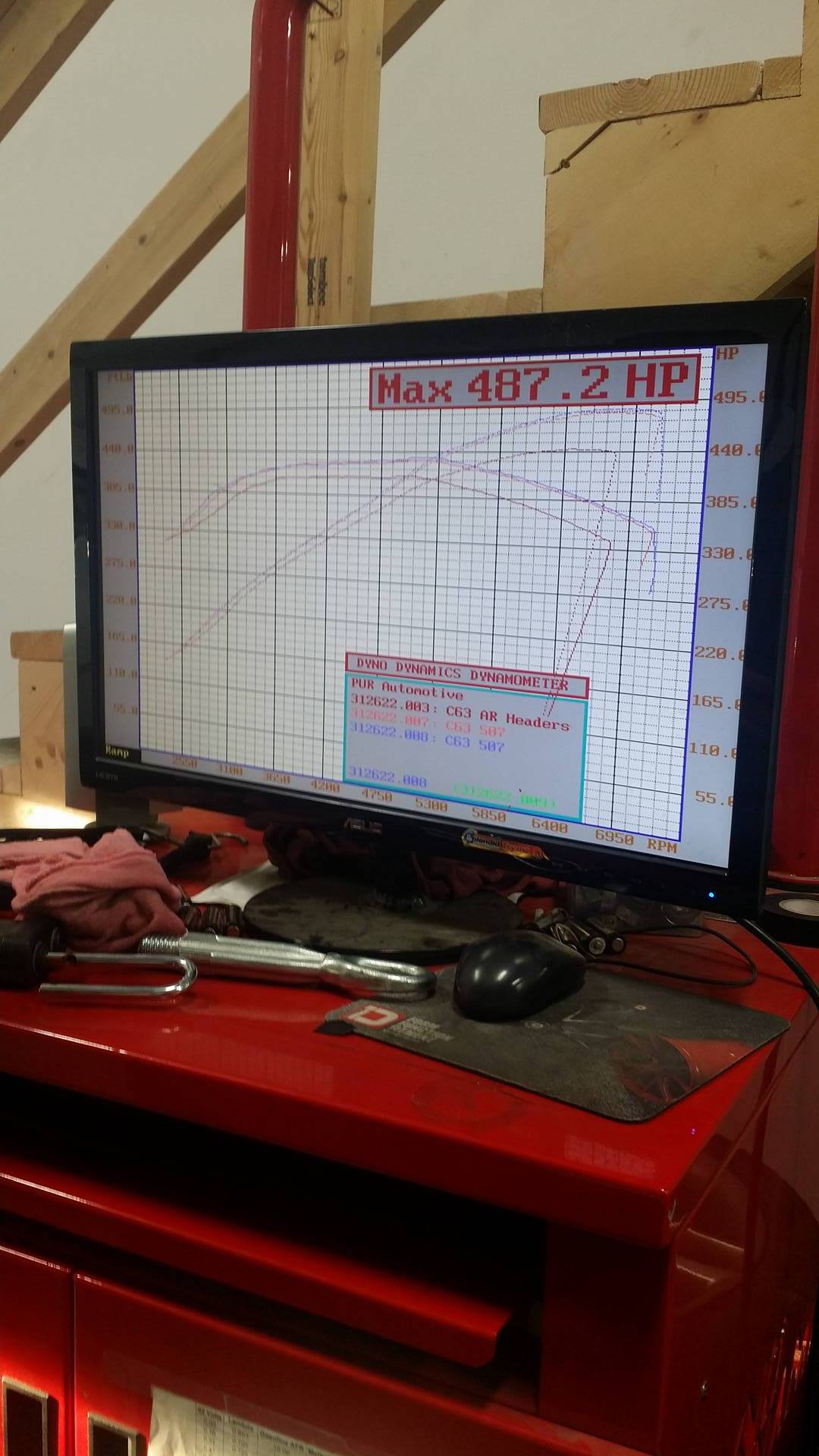

Hello everyone; some may remember a month or so ago, I've got the ported and polished heads complete at Eurocharged Toronto. I want to say I am quite happy where the car is at today. I have the MHP/ARH longtube headers with no cats, has stock rez and mufflers, carbon intake, weistec air filters, ported/polished heads and of course, the EC Tune. We did few pulls and each time seemed to gain few ponies. Last run, we let her sit down and cool off; after that ran 487 WHP on a dyno-dynamics. Videos show front and rear of car during dyno; videos never do justice on our beautiful musical notes from the 6.2 motor of course. Enjoy.

Nice result! Do you know how much hp the heads were worth?

Thank ya; Well; last dyno with headers was around 443 (didn't seem right but who knows..). After heads it was about 40hp jump.

What are the two graphs?? Is the stock graph the 440??? And everything else added the 487???
The graph has HP and TQ with few pulls
