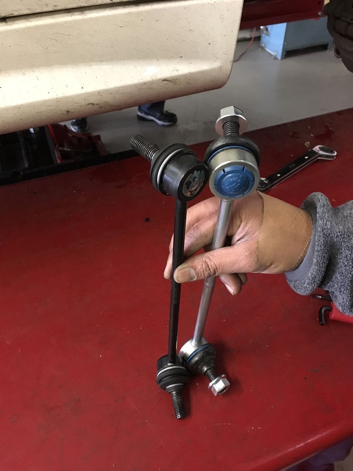

I got the replacement end link installed. Upon receipt, we immediately noticed that it differed from the one that came from the kit. However, it matched the photos on the instruction manual so I think it is safe to assume that the silver end link is the older revision and the black one is new. See photos below. Important part is that it is the correct right side end link. You can clearly see the difference in orientation. I also fixed the issue where the end links were installed in the front position of the damper, they are now installed in the rear position.
Unfortunately, the noise is still there! But it has improved. It is not as noticeable and only occurs when nearing max steering lock left or right. I think the source of the noise is really coming from the end links though. I don't know if I'm just thinking this, but the noise is now coming from the left, where the old revision end link is installed.
My next steps are to see if the noise will go away if I can get a hold of the old revision end link for the left side. If that doesn't work, I'm going to try aftermarket adjustable end links. I'm thinking maybe the sway bar is being too constrained.

@Mort - I'm going to try the Agency Power end links. Talked to them today, unfortunately one of the components are on back order. They're supposed to get back to me tomorrow for timing.
I agree with your measurements. The KW end links are about 10.25", the OEM ones are about 12". Last I spoke with the Agency Power rep, the range of the adjustable end links are 10" to 12". I'll have them double check tomorrow, but I think the range of the adjustable end links will cover the length of the KW all the way to OEM. Just an FYI, the shop that installed my suspension tried fitting the OEM end links with the coilovers and it wouldn't work.

Last update: I reported earlier that the noise became better and less noticeable after correcting the wrong end link. I went on a spirited drive last weekend, and the noise was LOUD, worst than the youtube video I posted on the first page. Something about driving it, something changes, with mileage or temperature. But when the suspension is working hard, the noise is just plain loud when I steer.

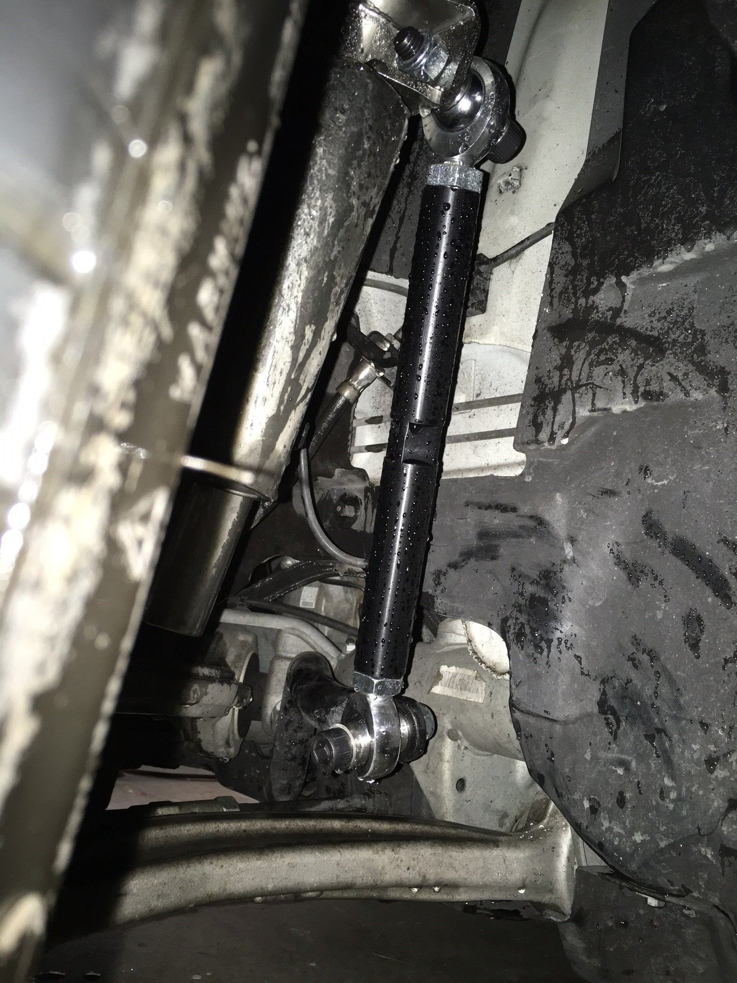

Agency power was able to pull in my order for the adjustable end links. After installing them, the steering noise went away! Here's my summary below:
Symptoms: Creaking noise when steering left or right, youtube video on original post. Sometimes goes away when cold. Becomes louder when warm and with higher trip mileage. No noise when steering wheel is kept straight and going over bumps. Steering also shutters.
Diagnosis: I strongly believe that the aftermarket end links that come with the KW coilover kit is too short, especially when lowered. When the end link is too short, there is a lot of tension between the strut mounting point and sway bar. When there is a lot of tension, there is binding noise coming from the end link. When I was removing the KW end link, I noticed a similar noise when unbolting the joints.

Here is comparison of the 3 endlinks, from longest to shortest: oem, agency power adjustable, to KW.
Here is the KW end link (disregard color difference, long story short, there different revisions). The length to the mounting points is perfect, BUT this is with the car on jack stands. The coilover is not loaded and is in full extension. This is not how it sits when on the road.
When trying to install the agency power adjustable end link with the car on jack stands, it is clearly too long, even at it's shortest end of the adjustable range.
What I did is jack up the suspension to simulate it being on the ground, how it would normally sit when driving on the road. The agency power end link now fits. This was my theory earlier when I said that the mounting point between the strut and the sway bar changes with ride height. Imagine the shorter KW end link in this position. It would be stretching it alot and putting tension on the sway bar. I'm no suspension expert, but I feel like all that pre-tension is not right and is what's causing the steering noise. This might be why one of the mechanics also notice some steering shutter, maybe the power steering was having difficulty with all that pre tension.
Conclusion: I think the agency power adjustable end links is a solution if you are experiencing the same sound as I am. I feel that the steering is lighter and more importantly, I have not heard the sound come back. I've been driving the car for over a week now including a long drive. However, I still need to take a spirtied drive in the backroad to really stress the suspension and see if everything is okay. Below is how it looks like with the wheels on and sitting on the ground. Looks like I can extend it a bit more if i want less pre-tension on the sway bar. Sorry for the rain.
Why some may be experiencing this noise and some not: there is variation car to car. There may be small dimension differences or revisions with the sway bar maybe. The other variable is ride height. I'm sitting on the lower side of the ride height range, approximately 12.75" from center of wheel to edge of top fender. If you're sitting say at 13.25", mounting point between strut and sway bar is shorter and the stock end links would not have as much tension.
