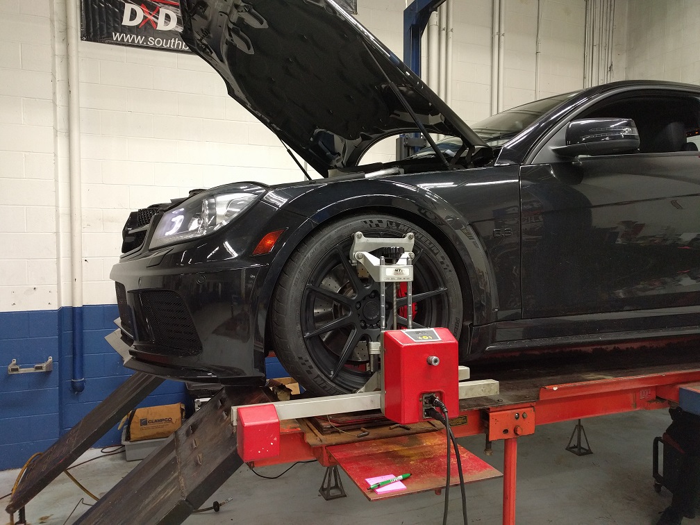

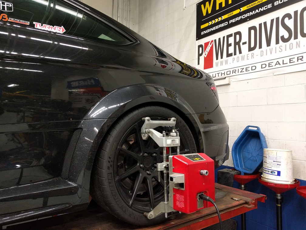

Wobble, did you need adjustment bolts for your KW install to bring alignment back within specs?
Old Dec 30, 2015 | 10:04 AM
Wobble64's Avatar
Joined: Apr 2014
Posts: 1,001
Likes: 53
From: Cincinnati Area
C63 507 with BS Body; 2008 SLK 55
I did not want it in OEM spec - I now have a little over 3 degrees of negative camber in front and a little over 2 degrees in the rear.
In front I would have been able to adjust to even way more camber (up to 6 degrees). The rear is not adjustable without special bushings. However, what I have suits me fine for my purpose (spirited driving and tracking). The car is now pretty low
