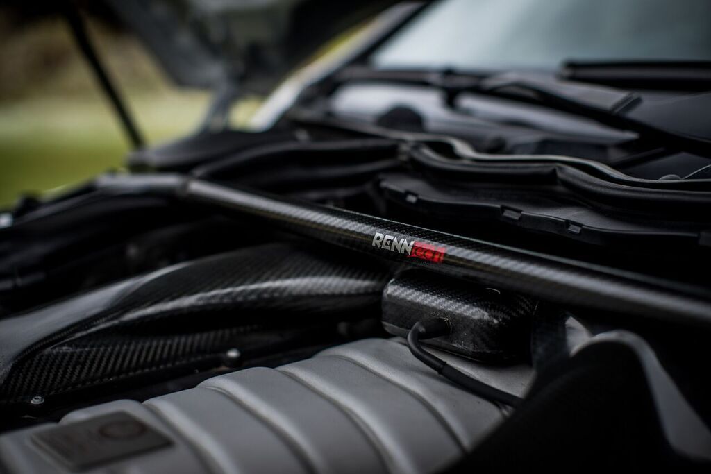

I have both of them, also had the opportunity to construct my own versions of these strut bars.
There's a few things the posters above me failed to mention, with a chassis as rigid as the C63's, lateral movements of soft moving parts of the suspension tend to ware more quickly. Not saying things will break, but they ware and soften up quicker.
Strut bars help relieve some of this lateral movement, I can attest from personal experiences owing the renntech bars and several aftermarket options, that I feel the car more confident during turn ins at speed. Placebo effect possibly, but its enough for me to enjoy the car near its limits and feel comfortable doing so.
Just my 02, really and truly these things are subjective. Unfortunately the Renntech pieces are astronomically priced. If the price of entry was more accommodating I would only assume you would see more members running them.
