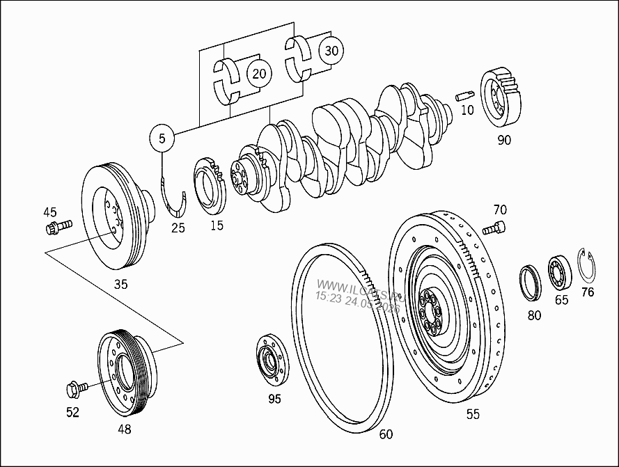

Okay, my opinion is the potential problem in the engine it is not designed for a manual gearbox and If it only has crankshaft thrust bearings at 50% of a engine designed for manual or automatics.
P/N A1560330262 qty 2 an engine for manual would need to have 4.
