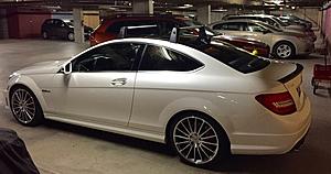

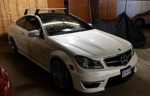

Here is how the rack looks installed on my 2012 C63:
(But note that I have not yet installed the rubber strips that run along the top surface of the aero bars, as I first need to install a set of tabs for the Portage canoe kit, THEN the rubber strips. The rubber strips protect the canoe, bicycle, paddleboard, etc from damage via rubbing on the aerobar)

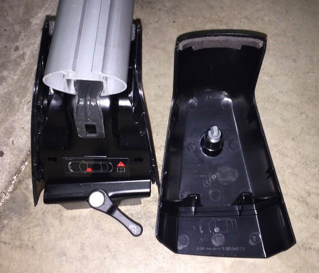

Each tower, and also its individual COVER, is indexed and LABELED for a specific location on the car(look closely):

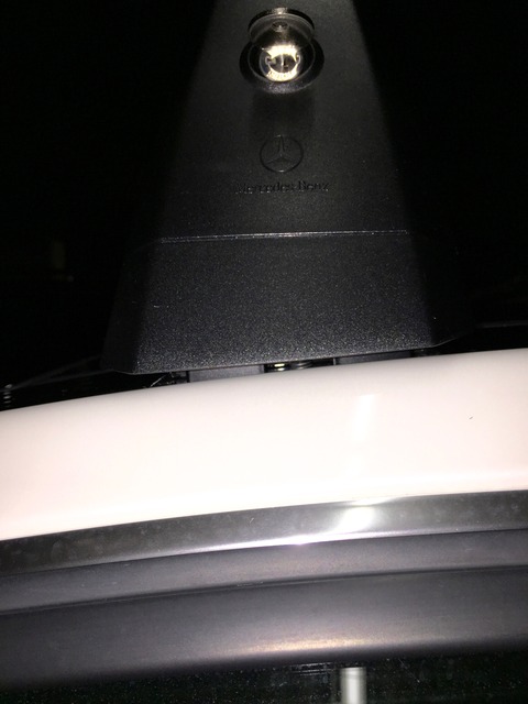

Once properly installed, each tower does not touch the car's paint ANYWHERE (notice the ga.Only the BOLT and 2 hidden tabs connect to the car:

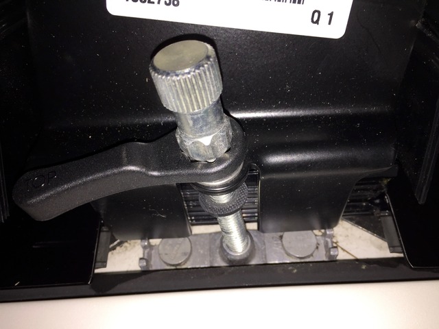

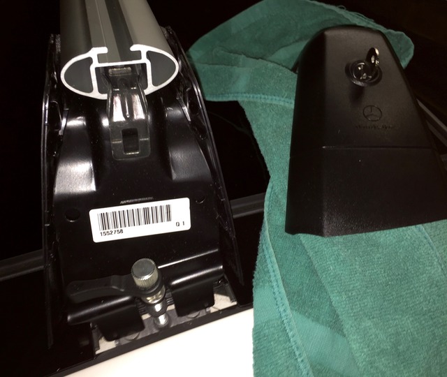

The next 2 photos show the hideen tabs misaligned and then aligned. They must be aligned in order to secure the rack properly and in the right location! This is easy to do, but you have to KNOW to do it (see the instructions for the rack):
Roof Rack epic story with part numbers and width!-1-20roof-20rack-20-20misaligned-20tower-20tabs_zpsgxx7dkau.jpg
Roof Rack epic story with part numbers and width!-2-20roof-20rack-20alignedtower-20tabs-20and-20locking-20cover_zpsottgxjlh.jpg
The green rag is what I use on the FAR end of each aerobar when installing each aerobar, to ensure that far end does not scratch my point by slipping down the roof.

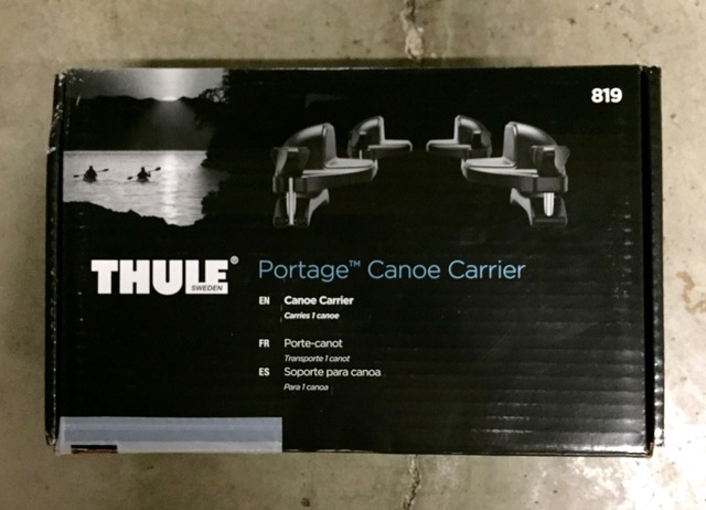

Here's the Thule Portage kit for hauling canoes:
Roof Rack epic story with part numbers and width!-7-20roof-20rack-20-20thuleportage-20kit_zpsoid74xry.jpg
I have not installed it yet, as the Thule dealer is getting me 2 extras that make the kit far nicer in appearance and more secure.
