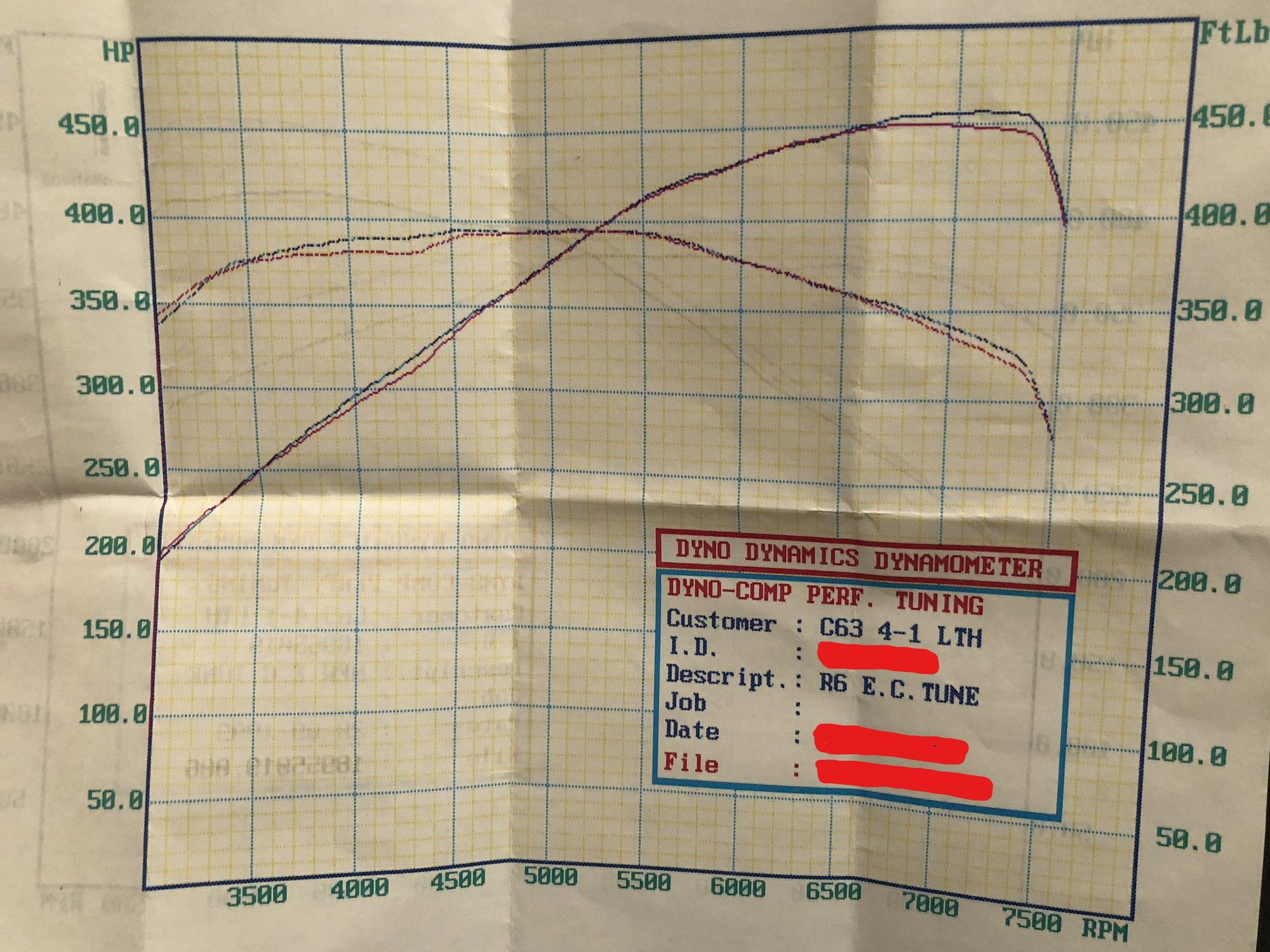

Stock car with high flow filters and secondary cat delete made 370whp on 91 (Forgot to print but will post when I can)
Eurocharged v6(red)/v7(blue) + arh catless long tubes made 450/390
Returned the v7 and got a custom dyno tune, made 475/425

hmmmmm, my EC v7 with catless headers made 472/435
did you only do one pull on the v6 flash then flash right over to v7 and do only one pull?

did a few pulls, those were the best for both software versions. But yeah, flashed v7 then did a few pulls so that may have affected it a little since it didn’t have time to adjust.

Strong numbers for Arizona, but it's hard to visualize without having both on the same dyno chart. Anyway you can have dyno-comp put V7 vs custom tune on the same chart?

I’m sure they would if I asked.

Might've missed it but were these runs done on the same day? If not, similar conditions?
Reply 0
May 3, 2018 | 03:47 PM
Quote: Might've missed it but were these runs done on the same day? If not, similar conditions?
yes same day
