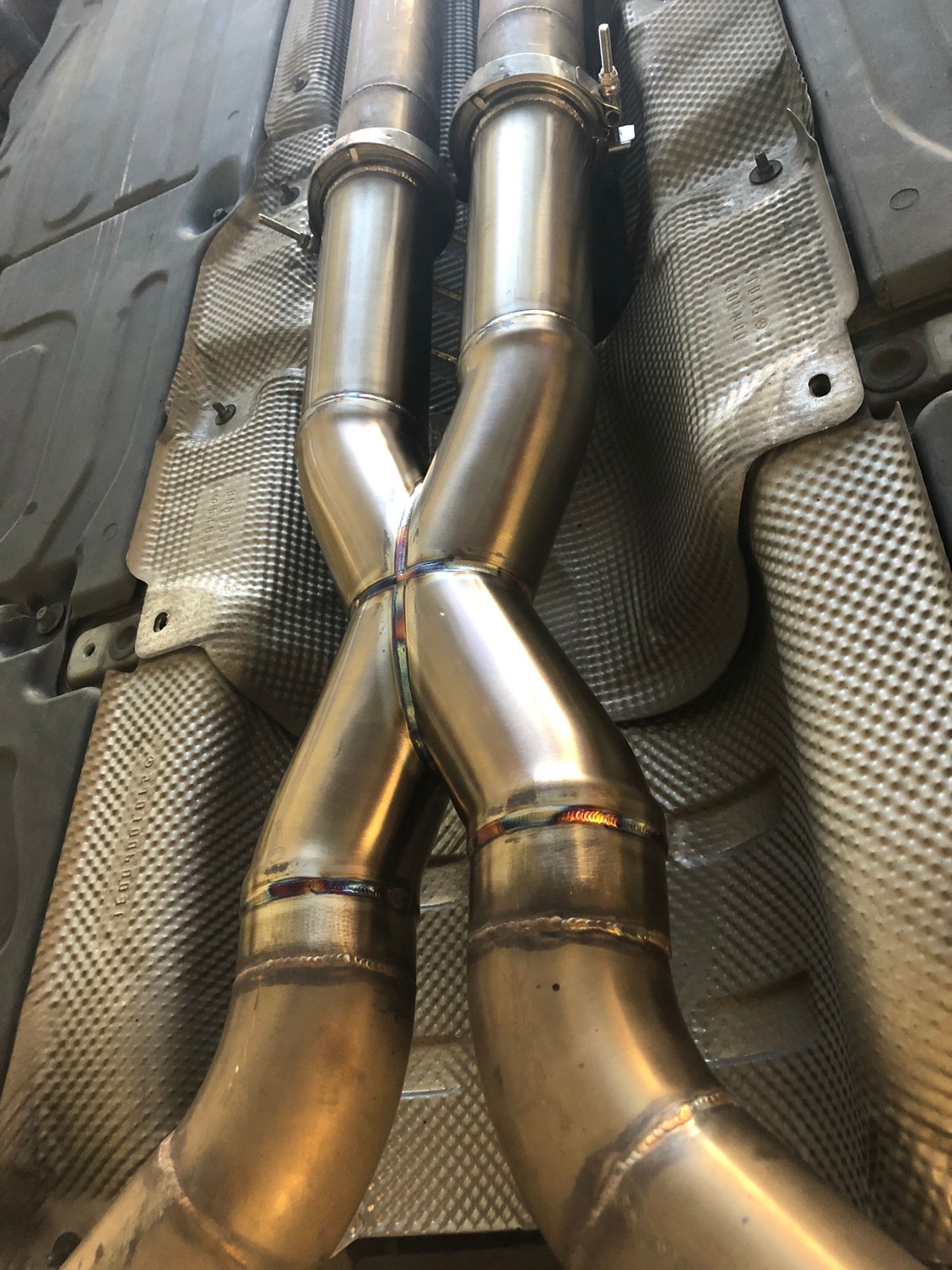

I didn't know it would be this hard to add power and keep the signature AMG sound everyone loves about these V8s. I have never cared about the actual loudness, my goal was to just keep the sound the same at any loudness level.
I need to make some videos but I would say this is what my car sounds like, which a select few will like but Im not trying to gain attention.

Take the x pipe out,change plugs and filters and add back the OEM resonator.
Did you log the runs to see if the car is pulling timing and see what the intake temps were?

Yes, my next step is adding back the resonator. The tune was from eurocharged, and I would send the graphs and he would supply a new tune, then make a few runs, adjust, new tune, and so on. We did this five times during the day so I’m assuming he was playing with all those parameters.
I have a kleemam shop about 30 min away so I may go in and talk to them too.
