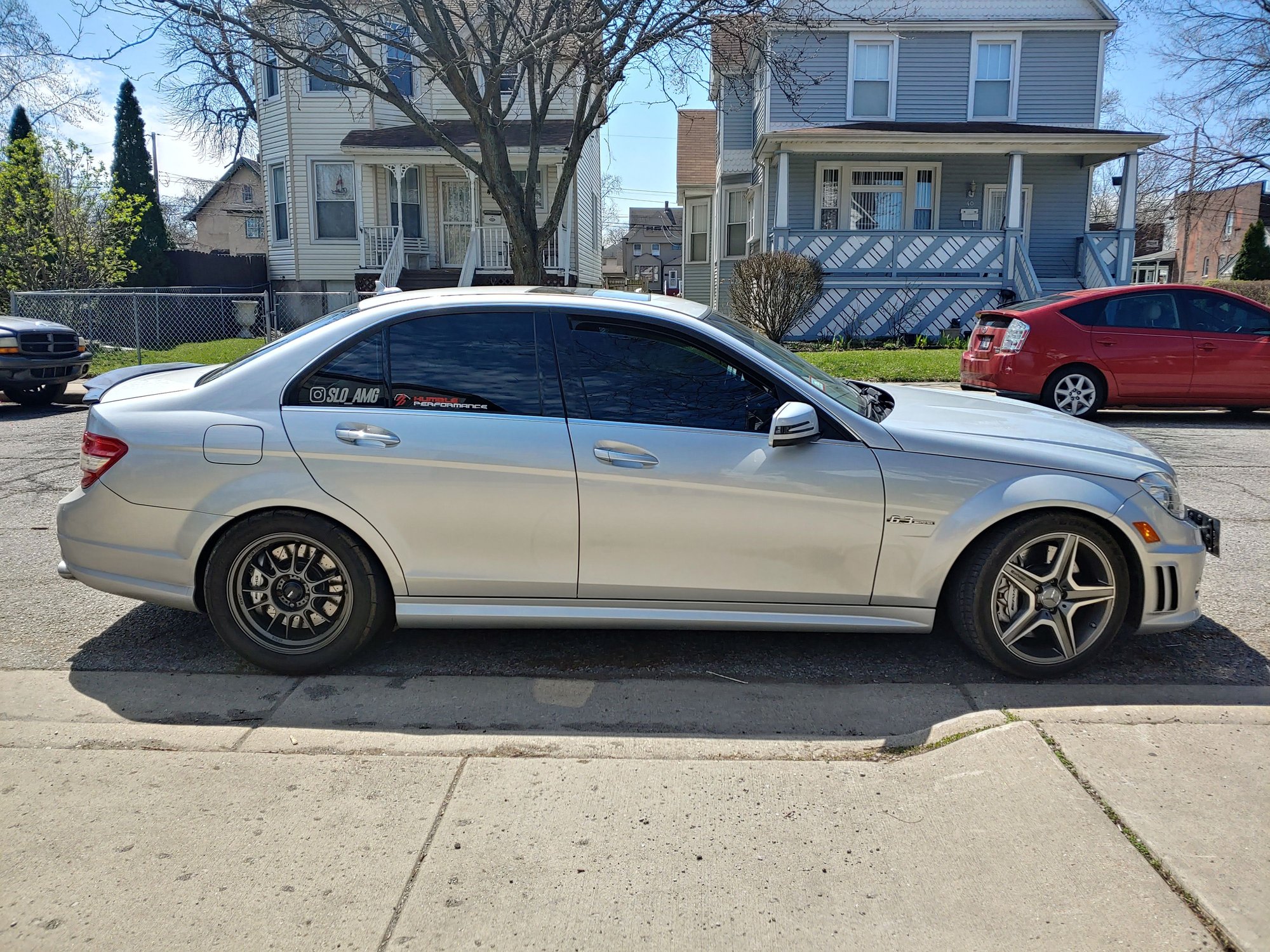

My '11 palladium silver on
Konig Wheels FTW
My Dailys 18x8.5+43 Konig Hypergram on Falken Azenis R Just barely clears the front brakes Good thing i did my research on sizing/specs haha
My Drag set Konig Hypergram 17x8+45
