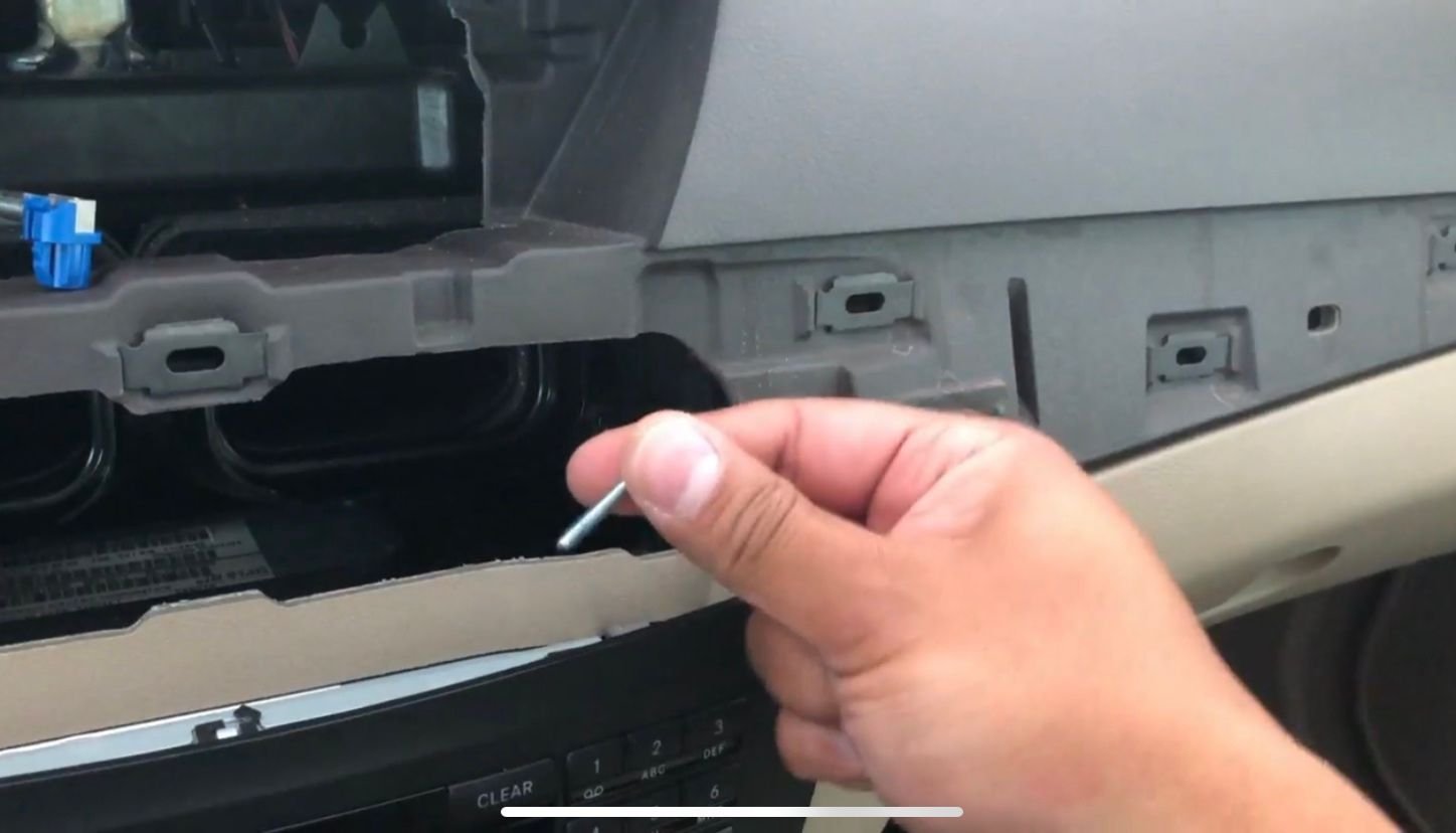

Hi all,
I’m looking for the part number of the two screws that hold the Comand HDD unit/CD player into the dash; the two torx head ones that sit vertically and lock it into place which can be seen once you remove the central air vent. I had my unit out recently to rid a rattle and I damaged a head on one, and since I plan on going back there for Car Play, I want to replace.
I went to my dealer but they are useless. Can anyone help me at all? This is last resort of course, after searching.

Reviving this thread: I lost the 2 locking mechanism brackets as I pulled the screws out too much on my 2016 E550 cabrio. I ordered 1 pair (Link) but I have NO idea how to install it, as it seems impossible to put it back in place from the opening where the COMAND unit was. Anyone knows how to put them back in place? Do I have to remove other parts first?
Thanks!

Hi. Did the locking mechanisms fall down out of reach? If so, did you work out how to get them back at all or what to dismantle to get at them?

I took the screw out and the mechanism fell down to where I can’t see it unfortunately. I wondered if you managed to retrieve the locking mechanism?

I don’t think you understand. The mechanism that the screw screws into dropped out of sight. Is that what happened to you? If so, how did you get it back?

Unable to find the bracket if it drop down, happen to my car

Did you find a way of getting of retrieving the locking tabs?
I have had the same issue.
loosened the screws to remove headunit. Fitted a new android screen and the head unit would not lock back in to place.....nightmare!!!

Jonny, did you manage to resolve this issue. I have the same problem.
Locking plates fell when I loosened the screws.

Seb, did you manage to resolve the fitting of the locking mechanism for the head unit.
Mine fell when I unscrewed the unit.
Any info on retrieving or fitting back would be greatly appreciated
