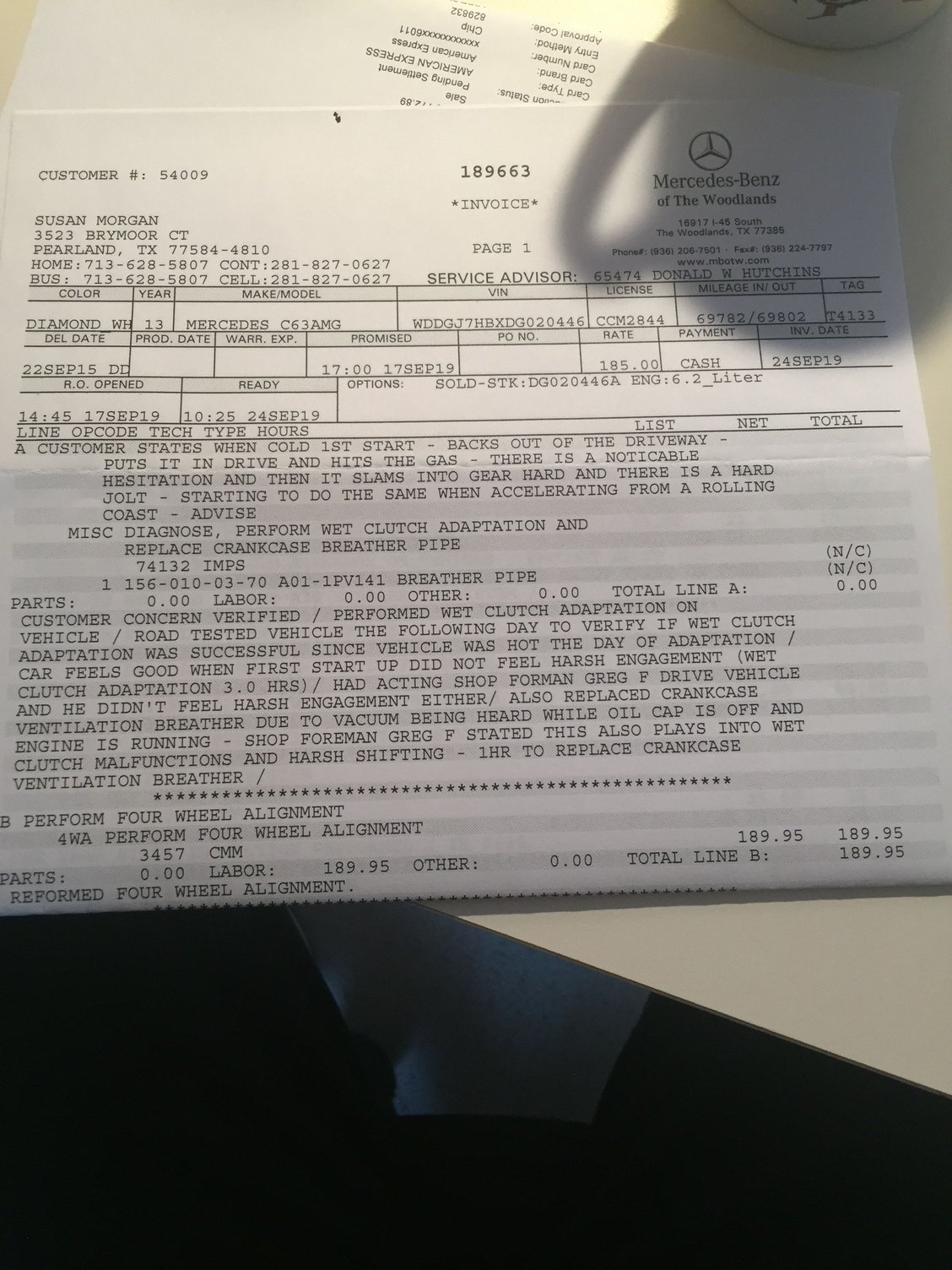

My issue has finally been solved. I'm on record with MB with having tranny problems for a few years now. From Park to Reverse wasn't too bad. It's after I'd back it onto the street and put it in Drive is where the mystery always happens. BANG! Sometimes. Sometimes not. It became a guessing game.
Issue: Customer states when cold 1st start - backs out of the driveway - put it in drive and hits the gas - There is a noticeable hesitation and then it slams into gear and there is a hard jolt - Starting to do the same when accelerating from a rolling coast - Advise
Solution: Customer concern verified / performed wet clutch adaptation on vehicle / road tested vehicle the following day to verify if wet clutch adaptation was successful since vehicle was hot the day of adaptation / car feels good when first start up did not feel harsh engagement (wet clutch adaptation 3.0 hrs) / also replaced crankcase ventilation breather due to vacuum leak being heard while oil cap is off and engine running (1.0 hrs).
NO CHARGE! Car's an animal now and no tranny problems. 70,000 miles and counting.

I found it. Here's a pic of the repair order and what was done to finally (YEARS!!!) fixed the problem. Hope it helps someone else.

My fluid was changed just a year ago and reflashed. But still the problems continued. The wet-clutch adaptation fixed all my issues. Matter of fact, I had to pull the car out of my garage so I could turn my Macan in at a 45 degree angle (this gives me a ton of room and lets me walk all around the car).
As I backed it out onto the street, I dropped it in D and gave it gas. IMMEDIATE & SMOOTH response. No more issues. No banging; no lag. As shown above, it takes 3 hours to adapt. Mine was done for free of charge since I had two previous repair orders showing this had been going on for at least 2 years.
