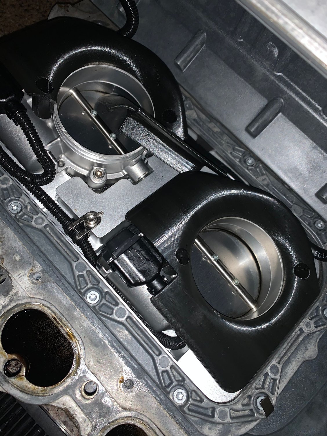

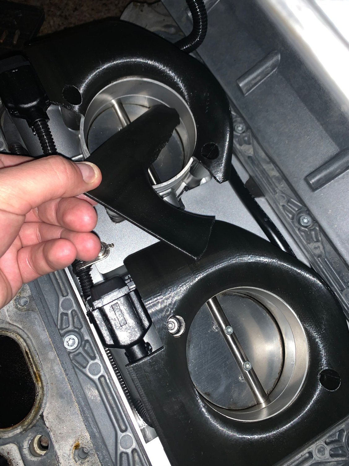

Fixed
One of the shrouds snapped and went inside the throttle body while it was opened. Removed both shrouds completely and car is running great

Wow, that's crazy. Never seen that one before. Good thing it didn't get sucked into the engine. Go buy a lottery ticket.
WHAT IN THE WHAT.

I have some good news for you ! Your car is not a 2012 base c63 coupe. Those are 82mm throttle bodies.

aren't those renntech throttles?

i concur...those throttles, 3d printed throttle body horns, aluminum shielding, and rear plate looks mighty nicer than stock.

Well "looking nice" almost nuked the engine
But hey 82mm tho

and people said my steel mesh reinforced epoxy airbox air horns would crumble. . guess 3D printing is clearly not better. it would seam that the 3D print leaves hundreds of seam lines that paired with harmonics and vibration can snap along those lines.
